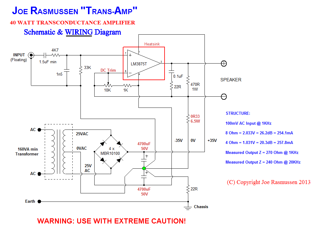

see above #25568 See the 0.R33 resistor?You don't get it he is not doing any of this stuff, and even denies it strongly. There is no sense resistor or feedback involved an ordinary amplifier connected directly to the speaker.

I called it motional (not cone movement) but I would say back-emf and is more accurate. Same circuit I am talking about.Still talking at cross purposes Richard, why is that? Motional feedback? Where does that fit in exactly?
This topology---->
That has nothing to do with his Elsinore speaker which is what we are discussing "a current or voltage friendly speaker". Why aren't you using it BTW, I don't see any of this on Damir's amps.
When he talks about back-emf (of any speaker system... his or others does not matter)..... then the resonance of the speaker will be the primary generator of the back-emf.
Using the back-emf can lower distortion at the resonance region in a way box loading cannot..... sampling the current.
A lot of what he was talking about relates also to his amplifier as shown. Maybe he just has not got there yet, here. But he certainly is using my idea. So, I am just jumping ahead.
EE's job here is to explain the reason for the distortion reduction from the driver.
THx-RNMarsh
jn is the person for this, he knows more about it than most. BTW the shunt networks on the speaker defeat the current sensing of the actual driver's current so you don't want both the current drive and impedance correction.EE's job here is to explain the reason for the distortion reduction from the driver.
Series resistance leads to more "current-like" drive, thus distortion may be reduced, depending on speaker. At the same time, frequency response will be more uneven, less flat. Electro-dynamic speaker needs voltage drive for the most flat frequency response. But, current drive is best for lowest distortion. If you want both, you have to use a current drive with DSP frequency response equalization (inversion of impedance curve). This is known, proven and discussed even in this thread. Active crossover (impossible to use passive crossover with a current drive), every speaker driven by its current source and DSP equalization of every speaker used.
That would be very interesting to hear. Unfortunately, it would have to be cobbled together to try it, at least I am not aware of an existing system designed to work that way.
There is a guy here who has designed and built it. With in-wall speakers. Unfortunately, I have not heard it, yet.
The distortion probably drops at resonance because the power required for the same acoustical output drops dramatically - in a severe case maybe by 6-8 dB ( power). If you are using current feedback, the effect will be even more dramatic.

It may look that way on paper (or CAD) but in practice, i did not see that occure with this fb topology. As I reported in the article, the bass was extended slightly as well No peaking noticed. A JBL D130 (15 inch ) in large enclosure volume. Measured both in rear loaded horn and in bass-reflex.Series resistance leads to more "current-like" drive, thus distortion may be reduced, depending on speaker. At the same time, frequency response will be more uneven, less flat. Electro-dynamic speaker needs voltage drive for the most flat frequency response. But, current drive is best for lowest distortion. If you want both, you have to use a current drive with DSP frequency response equalization (inversion of impedance curve). This is known, proven and discussed even in this thread. Active crossover (impossible to use passive crossover with a current drive), every speaker driven by its current source and DSP equalization of every speaker used.
