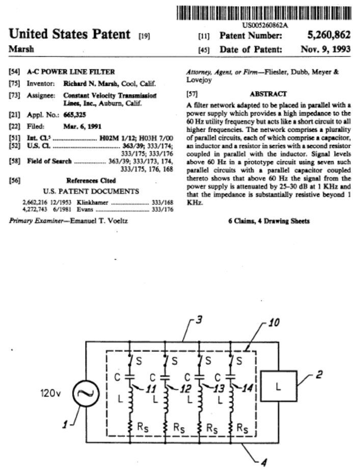

Here is US Patent 5,260,862 issued to Richard Marsh in 1991
View attachment US5260862.pdf
My most sited patent should have had prior art from the 1890's, I was surprised.
John, I think Scott's reply to my surprise hits the nail on the head. I'm more surprised by the awarding of said patent than anything, which speaks more to our patent system than Richard's contribution. Also why I wonder about its enforceability, given prior art.
As Richard wrote, though, patents are "complicated".
Patents like that remind me why my PhD supervisor told me not to take seriously any US patent. He said that they were all regarded as jokes in Europe.
LC traps like that were routinely used in TV circuits since the 1950s (and probably in radar circuits before that). How could a standard textbook circuit be patented? The patent examiner must have been astonishingly incompetent. Maybe he just searched patents for prior art?
Thanks, Mark. And, yeah, if the referee goes by Manny, that's just the guy you want doing all the patents for utility-level electrical systems.
Richard, that's what I was trying to say--the link I gave just showed the parasitic series inductance/resistance of the respective capacitors and the self inductance of the traces. Yours is a many-tap explicit RLC array. I'm admittedly surprised you were able to get this patent, truth be told, but 1991 means it's well past its last renewal.

The funny thing about this particular patent is that it relies on a low shunt impedance for the filtering action, which in turn only works if you have a sufficiently high series impedance for the mains supply. This impedance is poorly defined, and the patent description doesn't seem to highlight this basic flaw. All good mains filters have series and shunt elements.
