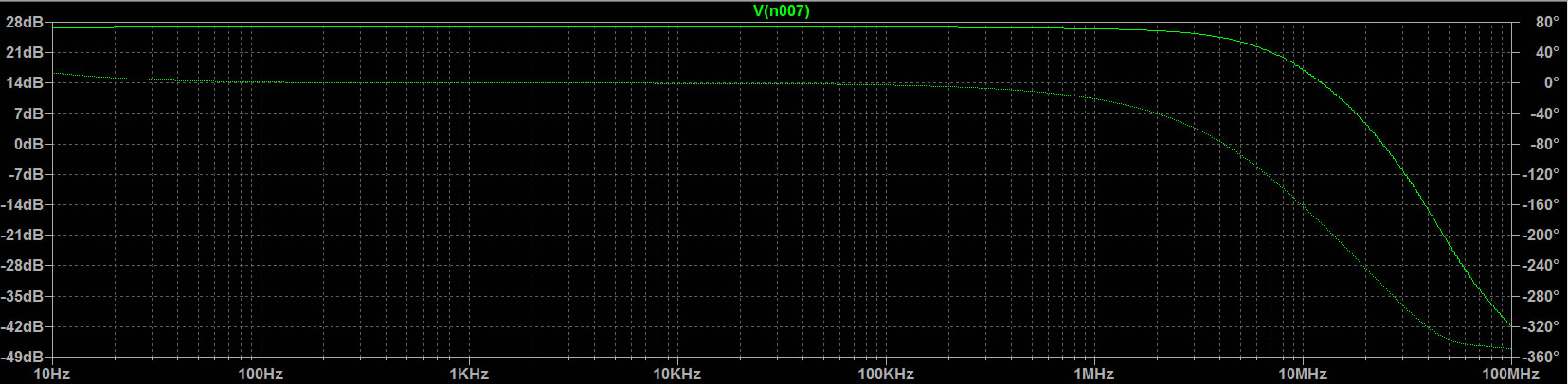

Neither am I. Richard and Dadod just discovered (the expensive way, unfortunately) the root cause why there are no known power amplifiers on the market with an ULGF of 6MHz or higher. Add testing on a shoestring and you got a safe recipe for a potential commercial disaster.
This is really not fair and very ugly from your side, as you don't know what's really happening with the amp in Thailand.
By the way ULGF is never higher then 4MHz in all variants I simulated of this amp and for the one built in Thailand is 3.4 MHz.
Anyway, apart the insulting "testing on a shoestring" and the definitive "No amp on the market" syn08 seems not to have a lot of experience with CFAs. This is the sim of my working simple CFA amp for treble (without the passive input signal filtering, of course.) Rock stable.
3.4MHz is still very high, and, as such, simulations mean close to nothing, in particular for a multiloop compensation network, designed by simulation only. Commercial amplifiers, even the much praised Accuphase CFAs, have ULGFs maximum around 1MHz.
If fact, as already mentioned many times, it is useless to use more than that for other than "because I can" reasons. I've once built an amp with an ULGF of 8MHz, it was stable in the loads I was able to test, but never tried to even post it on my web site as such, but as a more reasonable (for DYI) 2MHz version. The 8MHz is buried on this forum YAP - Yet Another PowerAmp
If you need to blame somebody, blame Richard for mentioning this issue in public, the rest is normal feedback of the "told you so" kind you should expect. I think your BFF Walter mentioned the same, while Bob Cordell elegantly snubbed you.
Ha. Ha. Ha.
No links for you, since I don't want to promote my hobby work in any way, shape or form. Those who want/need, they can easily find it.
P.S. Looking at your pic, until you come up with the details, I have to assume you are confusing the closed loop gain/phase with the loop gain/phase. Mind you, this is not potatoe/potato difference, but don't worry, you are not alone in such confusions. And even so, I doubt this is a power amplifier.
Ha. Ha. Ha.
P.S. Looking at your pic, until you come up with the details, I have to assume you are confusing the open loop gain/phase with the loop gain/phase. Don't worry, you are not alone.

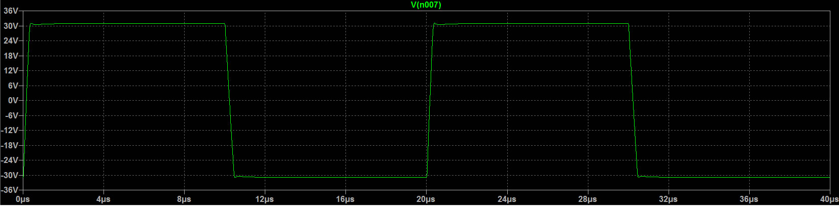

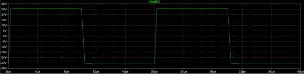

(sim square waves of my amp)
PS: No i don't confuse. Just too lazy to make a Trian prob just for the pleasure of arguing.
If truth is aggressive, then so be it.
Square wave showing the slew rate have nothing to do with the amplifier ULGF. ULGF is a small signal property, slew rate is a large signal property.
This not the slew rate. Slew rate has to be made in saturation mode.
BTW: I have no overshoot in little signals as well that's the way I compensate my amps.
This said, it is not the subject: Dadod had answered-you about the ULGF of his amp. Pretty amazing, if we consider the complexity of his work and the various various originalities of his demarch.
With all due respect, you have no idea what you are talking about. Please stay with the subjective prose, you are at less risk to make a fool of yourself.
Yes you do; whatever curve is the loop gain, it would mean your closed loop amplifier has virtually no feedback.
And once again, this is not a possible physical power amplifier. A 22MHz crossover frequency (if I'm reading right) is impossible to build, even in simulation (with real device models). If you want to be taken seriously, come up with a schematic, and somebody will point you to what you are doing wrong (in simulation, of course, as I don't think you had the chance to build it).
