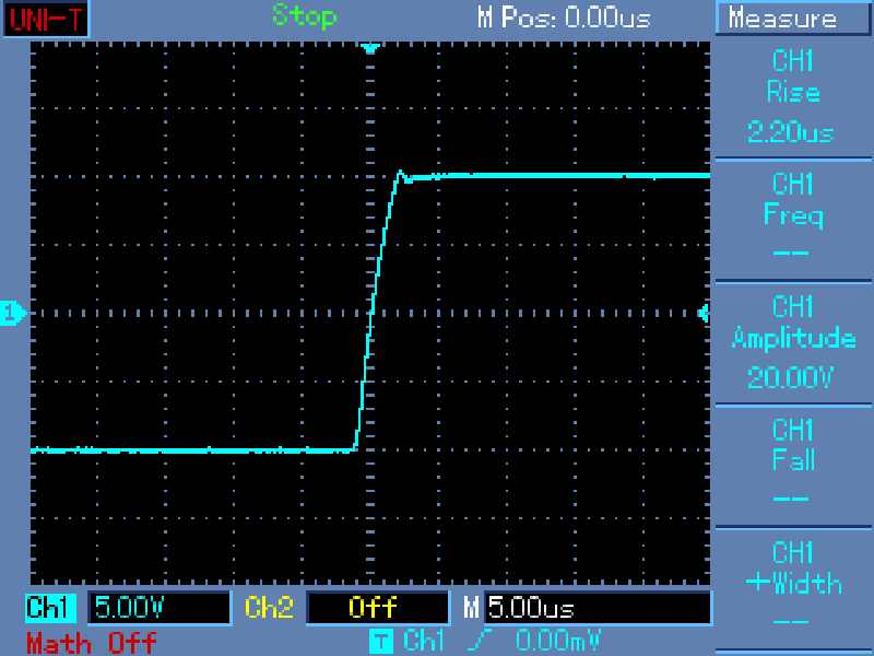

If I care or do not care about slew rate can be seen from a measurement of one of my preamplifiers
Ahem... rise time. Your preamp has about 500KHz bandwidth. Right at the limit of the AM radio band. Long wave stations in Europe (if any left) will go through 😀.
Your slew rate is likely much higher than the max derivative of this signal. And the derivative of a slewing signal is constant, doesn't peak.
I am really not sure what you mean when saying that "I should follow all the constraints (slew rate)". Sounds to me that I am supposed not to know what slew rate is and when it is important. <snip>
Sorry, I'll be clearer. The step/settling test is looking for a difference in a timeframe that your rise time falls within. From my military test experience, they always require the test capability be at least ten times better than the entity being tested. For example, to test the TRR of a diode with an expected value of 15 nanoseconds, using a test fixture waveform that changes value in 100 will not be acceptable.
To test settling times at the 1 uSec level, use of a signal that takes 3 will not show the entity.
To be more accurate, you should be in the 200 to 500 nSec range, and your measure should be from the say, 50% level of the input waveform to perhaps 90% of the output waveform. 90% of course is a debatable entity.

Yes, it is a little bit below the SR limit, it was difficult to get because the preamp would need to overdriven.
Attached is a slew rate of another preamp.

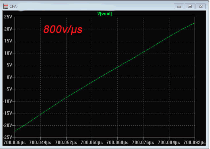

Attached the virtual SR (10%-90%, passive filters removed) of my last amp in progress. Yes, it is a CFA: I like, for the treble that my amps have time to take a little cigarette break between two level changes ;-)

The biggest problem with high slew rate amps is the pcb artwork.It's fairly easy to deal with high slew rate op-amps as the surface taken by the circuit is very small, not the same with high power amps.The good power amps with high slew rate are actually sounding darker and extremely boring, like having less highs while they actually are less zingy.
Yes, one of the issues. It is possible to design a well working high SR power amplifier, but it is useless for audio. Again, it is easy to calculate maximum possible SR of the audio signal and to build the amp with at least 10x higher slew rate limit. I have built a 2x300W power amp with SR = 120V/us. However, it is really useless. It is like all the discussions here. Hunting resistor distortion, cable delays, highest SR - and then we see that the real issue was an amp prone to oscillations under certain signal and load condition. I have to say that about 17 years ago, when the part I of this thread was started, I could learn something here. Unfortunately, during last 10 years, there is nothing like that. But I am afraid that the debate may bring a lot of confusion to the newcomers, which is probably the only outcome.
