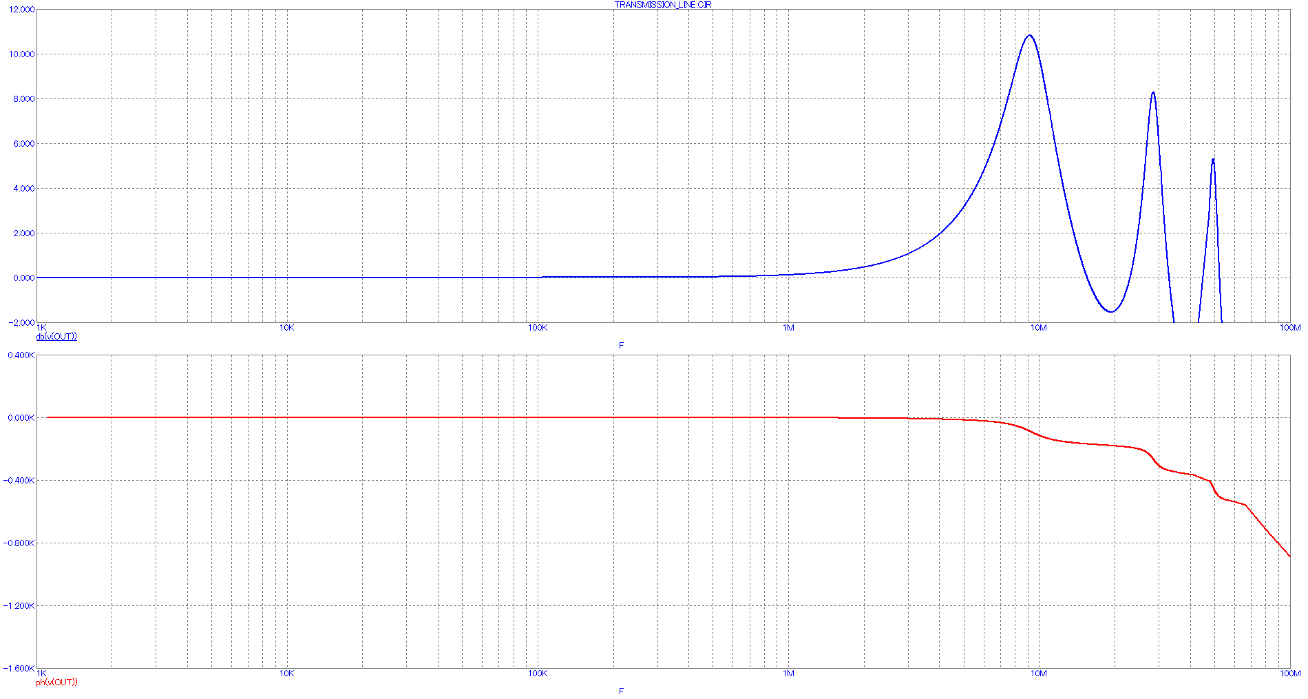

JN asked how can I see it on the scope. Just according to the definition, sinus sweep and voltage measurement. As simulated for 4m of cable, inp from 0ohm, output 1Mohm load. Simulated, however scope shows the same. First signs of "sub/wavelength" effects are above 1MHz.
First, that's not a scope. Second, it's not a time representation of the voltage at any point on the line.
"Look, a squirrel" is not an option here.
Your apparent fundamental understanding of what a scope can show with respect to direction of the signal is incorrect. A scope cannot tell you which direction, so cannot tell you which is forward, which is reflected. All it can do is show the summation.
When the signal is sufficiently slow that the reflection overlaps the forward, you simply say "no reflection". That is of course, not a boundary.
And that's it. Summation of waves at the defined point. If there are reflections at the given frequency, summation shows it. BTW, simulation and real measurement on 4m zip cord are quite in a good agreement, Rg=50ohm, Rload=1Mohm//30pF. My generator is limited to 20MHz. Frequency in the measured plot is in MHz. Gain in dB.
Again, where is the separation of reflected and forward?

My bad simulator MicoCap does not want to show reflections of 10kHz wave in 4m of T-Line. My bad oscilloscope does not want to show 10kHz wave reflections in a 4m of zip cord. No theory to support such thing and no publications exist. You guys still trying to get Nobel and compare this effort to discoveries of new small particles in physics? Then Bybee is serious to me, compared to this effort.

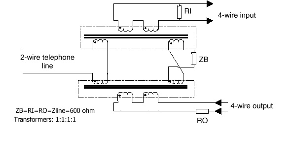

It is easy to distinguish between audio frequency signals coming and going. The original circuit used what is called a hybrid transformer. Today it is done with opamps and a balanced bridge. Yes there is some signal reflection whenever there is mismatch. Perhaps you have used a telephone and noticed what is called the sidetone or the amount of your voice that is in your handset varies. That is due to reflections from the old fashioned two wire telephone cable.
As to loudspeaker parameter shifts the DC resistance can go from 4 ohms to 16 ohms in a fully driven professional loudspeaker. Consumer grade midranges might go from 6 to 9 ohms. The inductance on a consumer midrange might go from .2 mH all the way to .4 mH. These parameters used to be monitored as the first large scale sound systems first had the ability to do so. Once the parameters were known it was much easier to set power ratings and limiters. Some gear will still shown the total impedance change.
Attached is a transformer hybrid circuit.
Yes, that's a directional bridge and would in principle work fine, provided you could match and balance properly the transformers (to provide enough directivity and isolation). Given the magnitude of reflections we are talking here it is unlikely that could be practically done.
This is one of those things much easier to do at RF, since Baluns would provide an almost perfectly balanced transformer.
It requires only one adjustable resistor to work. You can buy the transformers off the shelf. Pretty standard circuit and usage. Used by conference call telephone folks, call in talk shows, even old fashioned computer modems.
https://catalog.triadmagnetics.com/Asset/TY-146P.pdf
