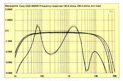

The effect of amplifiers with high output impedance - of many tube amps.
http://www.stereophile.com/content/cary-audio-design-cad-300sei-integrated-amplifier-measurements
PMA, you exaggerate the effects of tube amps on being a tone control. Yes, the frequency response will change somewhat, but it might even get better, rather than worse. I am now perhaps driving my WATT's with 0.5 ohms, at least, and it sounds just fine. This is a damping factor of about 10. My Dyna tube amps have a damping factor of 15, so why exaggerate the problem? You did the same with current drive. Who is to say that current drive, IN SOME CIRCUMSTANCES, isn't better? Your experience curve is fairly limited, as I found this out almost 50 years ago.
