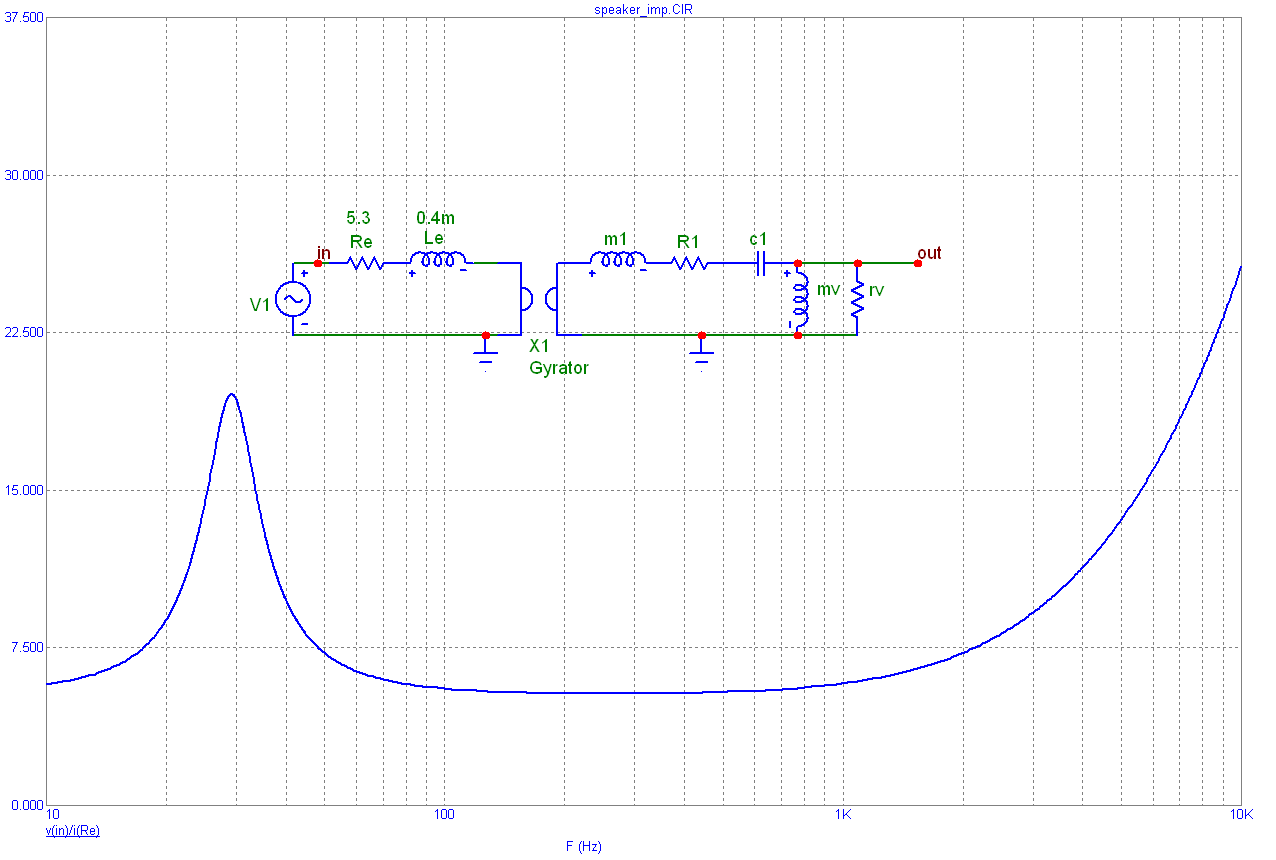

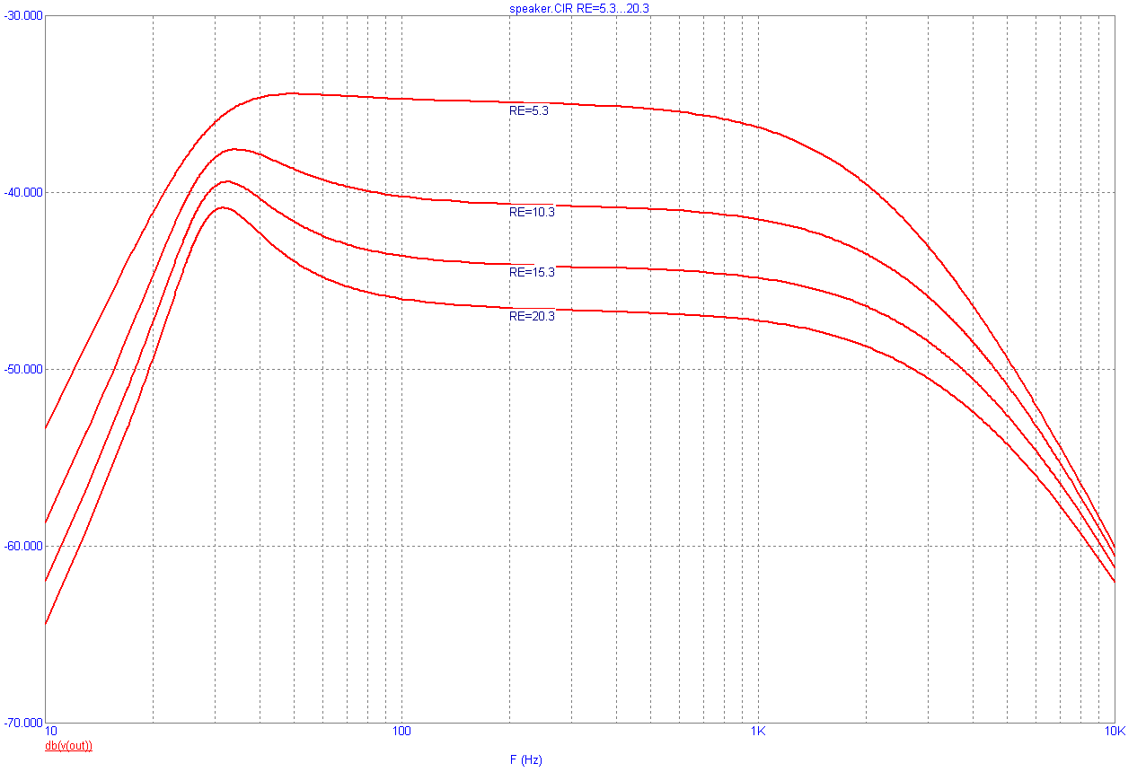

My last post to the idea of current drive of a dynamic speaker. 1st plot shows impedance plot vs. frequency calculated from the equivalent diagram shown. The 2nd plot shows transfer function of this equivalent speaker circuit with increasing voice coil resistance as a parameter (higher resistance = closer to current drive). We can see that when increasing voice coil resistance, i.e. approaching to current drive condition, the only thing we get is a resonance peak at bass frequencies and decreasing efficiency. Exactly as expected.
Did you consider that some drivers are more suitable for current drive than others? I can imagine taking a driver with a Qts of 0.7 (perfect for an infinite baffle), showing what happens when you put it in a vented box, then triumphantly claiming that, see?, vented boxes are no good!
Mills and Hawksford worked this current drive stuff out in pretty good detail. This was expanded on in a recent book which caused some lively discussion here. Nelson Pass wrote a very accessible "dummy's" guide, and right in our own Articles section, Morgan Jones demonstrated the utility of matching the right speaker with an amp having a high-ish source impedance.
Where is the power loss, PMA?
He's adding a physical resistance rather than creating a "virtual" one in the source impedance of the driving amp. The efficiency argument is, IMO, not totally honest.
Especially when the bass added by the resonance @ Fs
gives an 'apparent' higher efficiency .....
