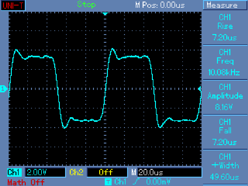

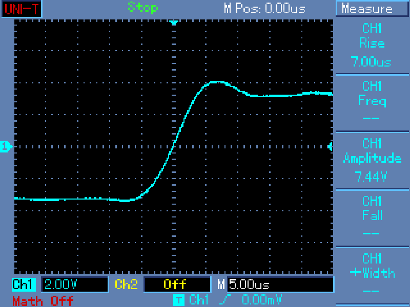

I am sorry, we have lot of measurements. It is impossible to participate too long time in never-ending discussions. The rise time of my CD player in SACD mode is about 7 microseconds (even for full scale amplitude). I do not know if it makes much sense to make new and new measurements to persuade someone. Time is money - I am not retired yet. We also have some interesting DSD analysis - please forget old modulators.
Hey, I asked a question. I don't recall suggesting new measurements. Thanks for the graphs, but they don't seem to depict rise times. If they were labeled then I might understand what you were trying to exemplify...
His graphs show the THD+N at 1kHz and 5kHz, from what I can tell. He said the rise time was 7 microseconds, and I think he is indicating he doesn't have time to take new measurements and post them here.
That's my take on it. I'm sure Pavel will correct me if I'm wrong.
For those who doubt about SACD risetime and slew rate. Measurements of rise time (7us) and 10 kHz square.
Single shot capturing, no averaging. Step-like look of 10kHz square rise and fall is due to digital oscilloscope.
