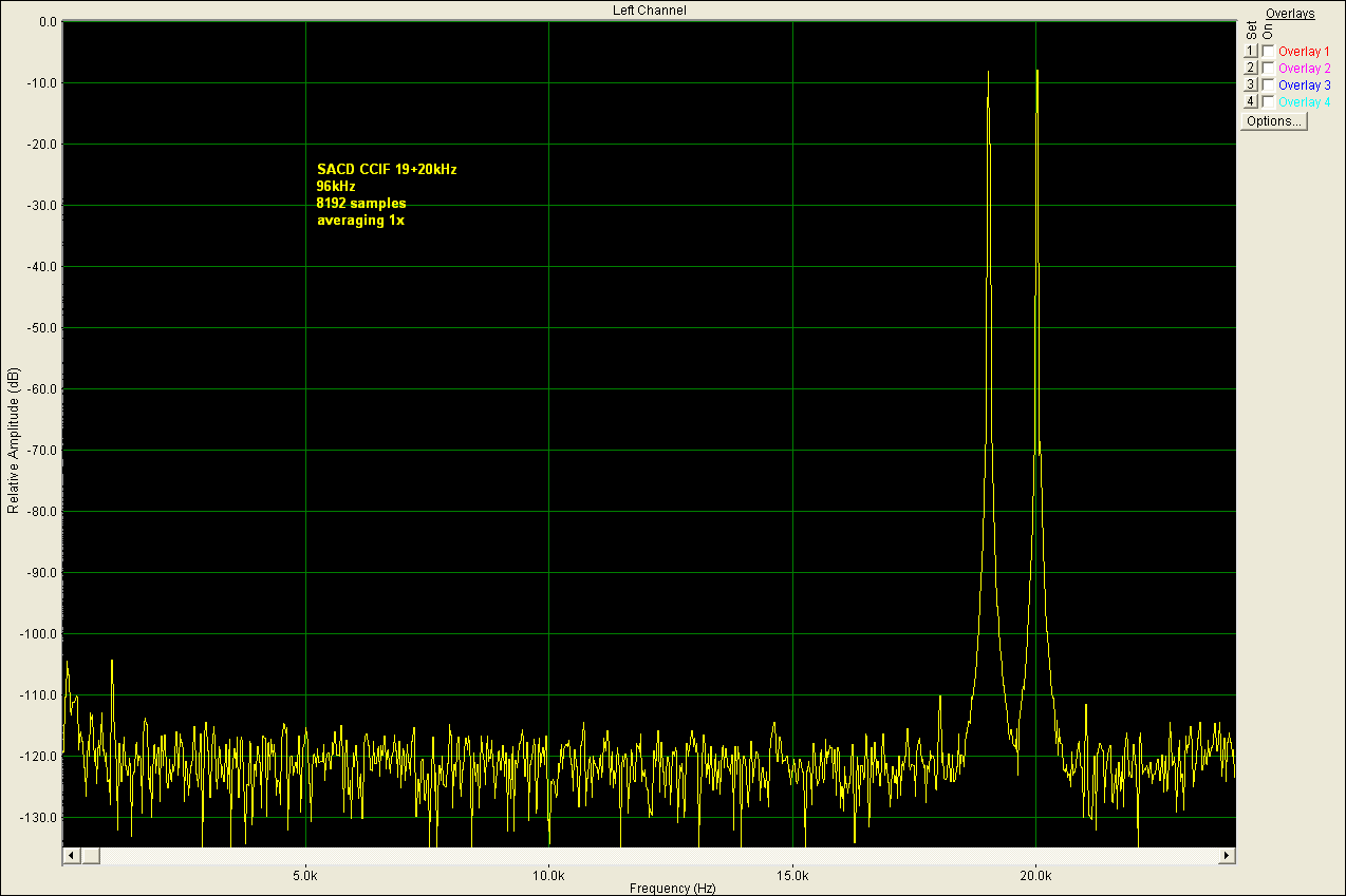

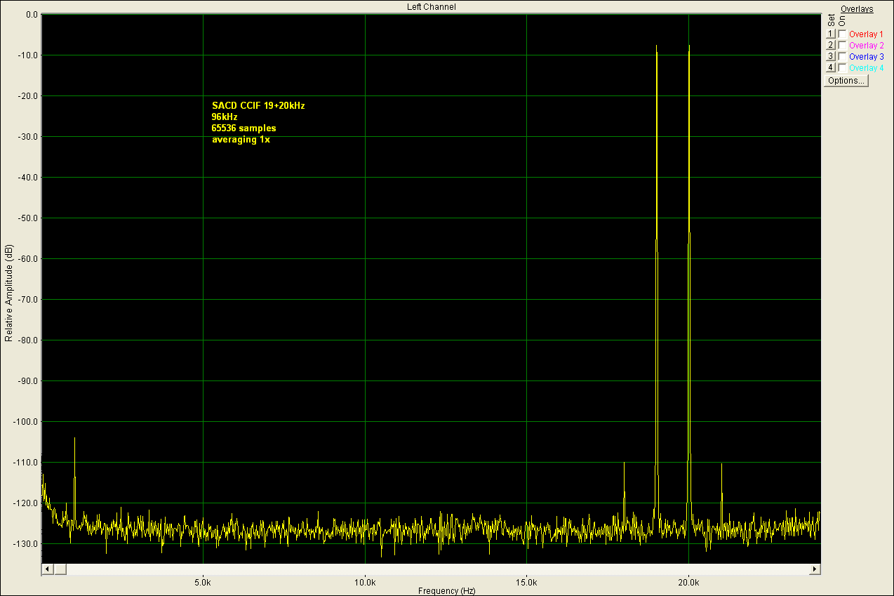

It's time to reveal an important fact about 19+20kHz IM measurements I showed yesterday. Yes, it is Marantz 7001. Yes, the converter is CS4397. BUT - in DSD mode. This is the key to spectral purity of the plots. In CD mode, the result is worse and we can see digital artifacts in FFT measurement, done with same resolution.
For once again, all 3 plots shown with text description added. The slightly smaller amplitude of spectral components in the last plot is a result of slightly different setting of the input divider of the measuring system, this measurement was taken some time before the 2 other plots.
Regarding SACD - yes, I think the short rise time and no ringing is very important. But same importance, IMO, is the spectral purity of output signal in audio band. The ultrasound noise does not matter.
Now, about time and frequency domains. Yes, the FFT amplitude spectrum cannot describe the signal completely. We may have 2 signals different in time domain with absolutely same spectra. We would need to add phase spectrum to get the whole description of the signal.

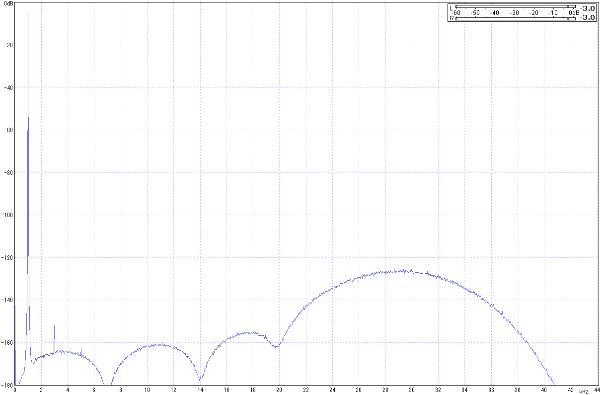

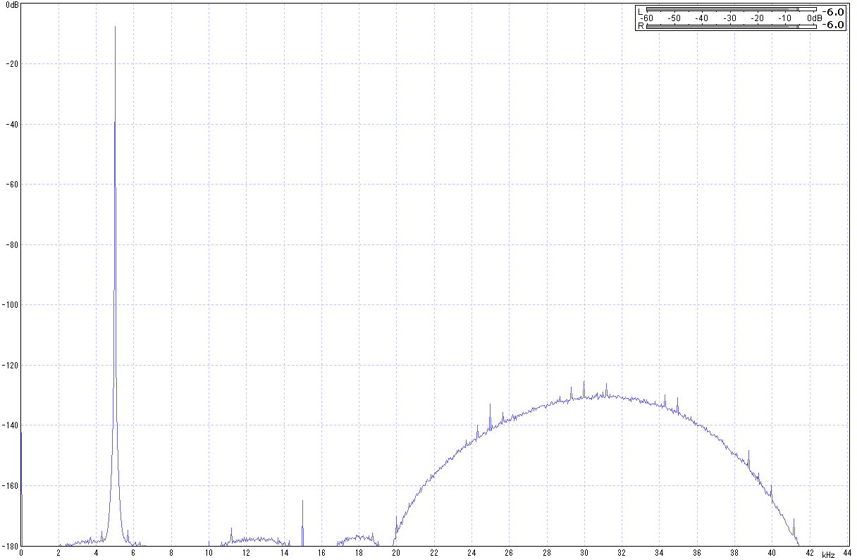

I am sorry, we have lot of measurements. It is impossible to participate too long time in never-ending discussions. The rise time of my CD player in SACD mode is about 7 microseconds (even for full scale amplitude). I do not know if it makes much sense to make new and new measurements to persuade someone. Time is money - I am not retired yet. We also have some interesting DSD analysis - please forget old modulators.
