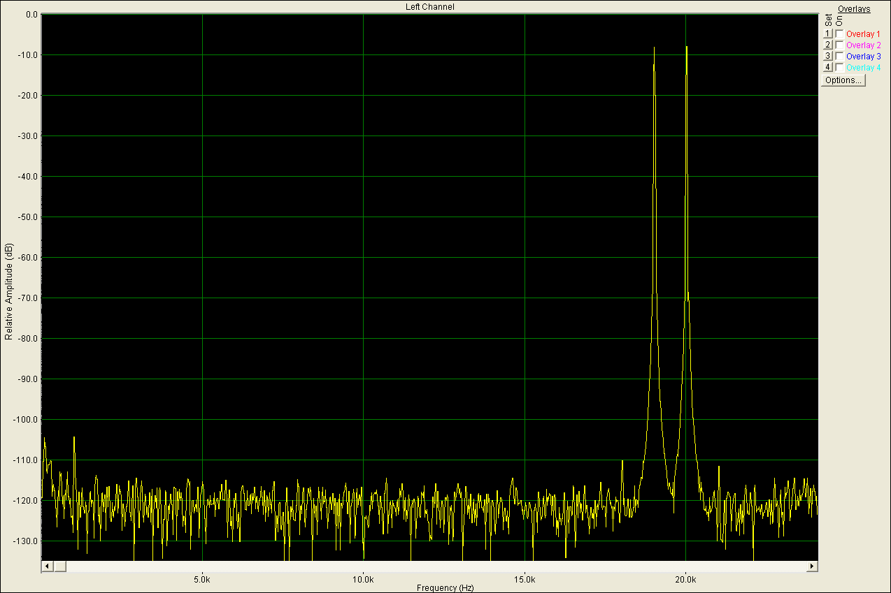

Nothing again.
What was your measurement designed to reveal?
These 9-14bit myths and speculations (by Thorsten) about modern DACs.
Well if you'd asked Thorsten nicely I'm fairly sure he'd tell you a measurement he'd made which showed the effect he's talking about. Then you'd not have to just muck around with FFT bins and averages.

Pavel,
So the fact that fewer samples strongly increase the noisefloor is "nothing"?
Can you think what the noisefloor would be like with 256 Samples? What would the noisefloor be with an analogue system that has a 130dB FFT noisefloor for 256 samples in the FFT?
Did you ever try the same set of measurements on a DAC that does not work on the principle of adding "Fuzzy" Distortion?
More to the point, did you ever listen?
BTW, I am familar with that Cirrus Logic Chip and as it so happens I also know the lead designer (long story, we bumped into each other at the queue at the "foreigner registration" of a Police Station in Beijing) and we actually even discussed his DAC designs in some detail. We even discussed the design rationales, driving factors and so on all the way to the kind of HiFi System he listens to at home (all strictly Sub Rosa), over some truely delicious Shaanxi style roast duck, cat ears and very quaffable Beijing Beer at the YinYang restaurant, previously frequented by Bush senior when he was US Ambassador in Beijing, riding his Bicycle there. Six degrees of separation and all.
Anyway, all this was really off topic.

Now 8192 samples. This means 85 ms. Nothing. Shorting the window only looses resolution.
Nothing again. Sorry, enough for now.

Pavel,
You have read the CS4398 Datasheet, right?
The modulator is 25 Level at 128 Times oversampling, so giving 3200 possible distinct levels. This is a dynamic range of 70dB.
As the Part is advertised as 120dB DNR we need to apply 50dB worth of noiseshaping to get this. Now how many samples of this 50 dB noiseshaping are needed to get the FFT Noisefloor for 120dB?
In other words, how many samples do we need to average to get 2 ^ 20 levels (which is what is basically 120dB DNR) and reverse, what is the maximal accuracy with which a single sample can be represented?
One of the methods that suits itself to revealing "hidden" behaviours of circuits is noiseloading, which is REALLY an old hat, I mean completely antique (it was antique when I started out in electronics in the 80's)and AP Equipment CAN (with substantial effort) be programmed to do something approaching this.
Anyway, all this stuff around dither and noiseshaping/modulation is really basic, the Lipshitz/Vanderkoy article on DSD is a good summary of the issues, though I find myself disagreeing with some of their conclusions (including, but not limited to the one that asserts that because they measure the same with a lot of averaging noiseshaped low bit converters perform identical to non-noiseshaped "Multibit" converters.
