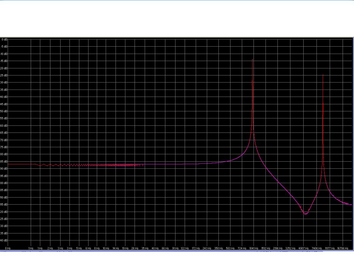

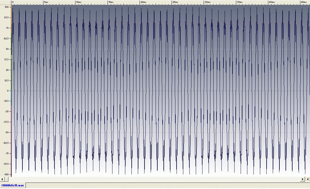

So any hardy souls venture to guess about this sound?
Seems like a mono recording, 2 tones ~ 1kHz and ~8kHz. I guess there are some more peaks above 20kHz (I bet that there is one more main tone).
What worries me is that I can’t hear the amplitude modulation (useless ears) :mad:
