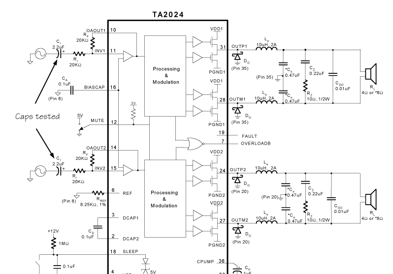

I was testing if a difference could be heard by changing the input cap of a Tripath amp.
...snipping...
This was a specific test in a specific application. I kept notes. I picked what I liked on music. Testing was done over headphones.

Can You post here simplified circuit, how was this cap conected?
Here is a not so simple schematic of how it was connected. There was a 50K pot between the signal source and the cap. Very typical use.
SY. No control for other sensory inputs. It was a sighted test. The only control was to repeat it several times over several days and keep notes. If my notes agreed, then I felt there was really a difference. Some of my favs lost in this test. I was hoping for small and cheap and good. Didn't find it. That's why the Janztens became the cost/size/quality champs for me. I did not test anything high dollar like Mundorf.
You know what comes next...😀
Thorsten, that is also how we generally compare two components, A or B. We don't even have to know which is A or B, just able to keep track of them with CHANGES IN MUSIC.

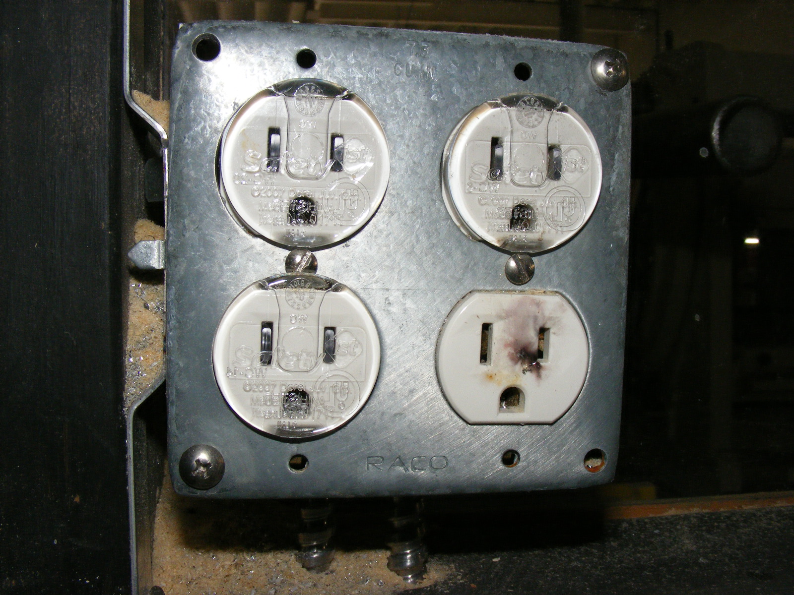

I was cutting some aluminum channel when it became clear to me why the music system would be improved by the addition of the plastic bits.
This picture may help explain why my music sounded better after I installed the plastic shields.
So even really stupid sounding changes may have a basis in reality. The other benefit is that it may help prevent my shop from burning down!

Sure. But I did not claim it to be a bullet proof scientific test. Just the best I could do at the time. I'm still pretty confident in the results, as I did my best to keep track. It was not always consistent, so that figured in.
Sometimes you just gotta say "Oh, I don't like the way that sounds" and live with it. These days armed with better test equipment and more knowledge, I'd try to find out why they sounded different. But I'd still listen first, test second.

Again your reasoning escapes me. The plugs don't touch the aluminum and the outlet holes aren't exactly direct acoustic channels to the insides. I see you already tried to burn the house down.😀

Pano, Bingo!
The dust goes everywhere, including behind the plugs. It caused a short circuit, which tripped the breaker, then the music lost volume. Cleaning the dust out, not allowing it back in and resetting the breaker, for some strange reason, the music regains volume!
It ain't exactly a house, sheesh we can't agree on anything. 🙂
If you look closely at the picture you can see aluminum dust mixed with saw dust, a really great mixture!
You must have really pelted it for the aluminum dust to make a bridge. I'm impressed!
Actually it made a nice big flash setting off some dust around the arc.
