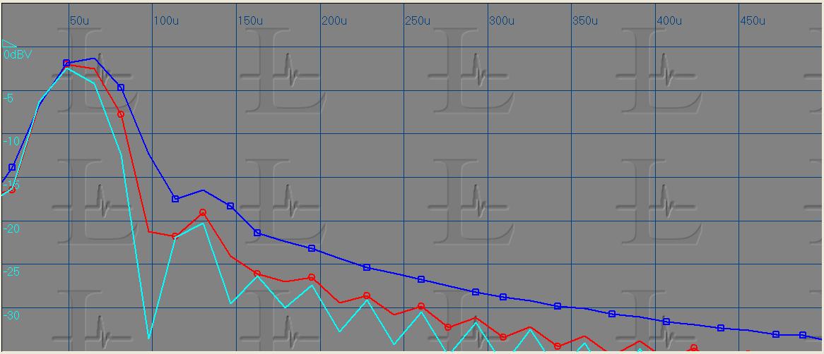

lvigone, can you post some of the pulse measurements you did ?
For example, the response of the "reference" amplifier, one for a similar sounding amplifier and one for a bad sounding amplifier ?

Fireworks,
my measurements could be of no value for you: they are the measurements of the best sounding amplifier in my system. In another system, the results could be completely differents.
The design of an audio reproduction system is like working with a kitchen prescription: the final result don't depend from a single ingredient, but from the sage mixture of all the ingredients.
Anyway, in attach you will see the three step "tuning" I made on my amp to arrive at the final best configuration. The light blue curve is the reference and the actual situation, the blue the starting point and the red the second trial. Moving from the blue curve to the light blue curve, the low frequencies became more defined and punchy, the middle more detailed and the high more aired: the image became more focused and solid rock.
What I suggest you it's to experiment: start from your amp, measure the pulse response, change this response in one direction then in the other and listen to the results. You will learn how to manage the sound!! I'm sorry, an absolute transient response doesn't exist: there are too many elements involved in an audio system.
Another hint: you have to find the actual "limiting" element of your audio chain. In my experience it alway exists. At first, make the pulse measurement of every single component (i.e., pre-amp, power-amp, CD player, phono stage, interconnects, etc.), then make the pulse response of the complete chain and look at the result; you should study carefully the complete transient response to identify which is the limiting element. Then, start to work on this one. When you will be satisfied, repeat the complete process and do the same on the new limiting element. The improvement margin is great.
You will be astonished from the change on the sound you will gain without making any change to the "traditional" distortion figures.

Thanks for the details !
I am aware that your results will not be useful for other systems but I'm just curious to see different pulse responses and the associated sound "qualities".
On your graph, can you also show the input pulse ? Is it a Dirac, Gaussian or something else ?
Another question: what software you used for measuring the pulse response ?
Could you, please, tell us, what measured did you implement for getting from the blue curve to the red curve?
Did these measures really not affect THD and IMD figures?
I changed the value of the capacitor that creates the circuit dominant pole: passing from blue to light blue its value was decreased (by the chance, this amp is a NO NFB design, so this modification didn't affected the circuit stability). The transient response is related to the transfer function of the amp, so to change the pulse response the transfer function of the amp+power supply+layout parasitics capacitances and inductances has to be managed.
It seems, You was simply changing BW of your amplifier. More BW= more details (mids, "airy" treble), speed(bass attack). Red curve pulse response shows "something" band limited well inside audio band (if time axis in meausurement is correct)...
