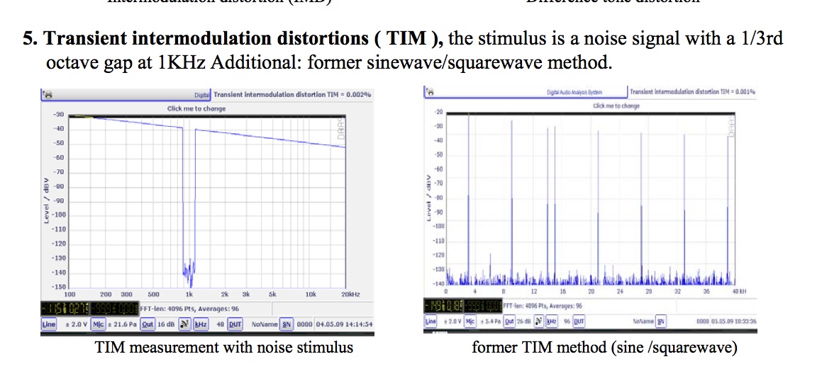

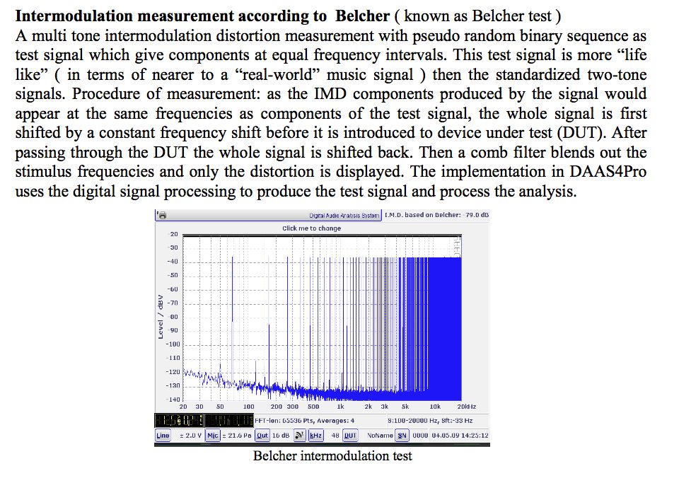

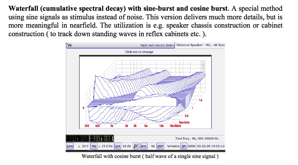

Here are screen shots how the DAAS measures dynamic distortion.
Joachim, this is quite interesting. The closest to this I have ever come is the ISO34 multi-tone stimulus which is part of the AP software package. As the name says, this is a 34-frequency multitone. The frequencies are spaced such that the harmonics and the IM products all fall between the stimulus spectral lines. So, what you do is remove the spectral lines of the original signal from the output signal and what is left are the HD and IM products of the complex stimulus. It is then just a matter of number crunching to unravel the the various products. In fact, you can even measure the freq response by looking at the response to the original signal, and even measure the noise in the presence of signal by looking in the fft frequency bins where there is no signal!
But, this is limited to 'only' 34 frequncies at a time, and I would expect the pseudo-random signal you mentioned to be even more complex than that.
Whether that gives even more information about the performance of the DUT is a question - with the waterfall you showed, I think it is not easy to draw conclusions of what is good or bad of the DUT, and how to make it better!

Jan, this is correct. Trouble is with modern types of measurement that we create all kinds
of nice looking pictures.Sonograph, Cepstrum, Wavelets, Droplets, Foglets, Wigner Distribution, you name it, but physics has not changed the last billion years.

Joachim,
Noiseloading. Cool.
I have been preaching this for decades, we used it in the 80's in east germany, but without FFT and such, Just switchable calibrated bandstop/pass filters, 'scope and AC mV Meter...

Jan,
See the first picture... Noiseloading.
It can be also (with difficulty) done using an AP2...
Noise with a deep notch (or several). Measure how much the signal "notch" fills in with DUT.
I once proposed this test to a famous (UK based) designer working for a famous audio company as a way to see what really goes on.
He found that his "24 Bit DAC" measured < 60dB dynamic range this way...
Ciao T
