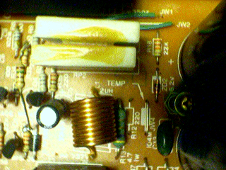

By JC - It is complete foolishness to use a 2 uH output coil, of any kind and design, unless you are interested in applying more negative feedback.
Besides the fact that you said one should never use MORE than a 2 uH coil , I see inconsistencies in your opinion(s). 😕
I did scope a DIY amp (my amp) with a piezo speaker array , saw more ringing w/ sqaurewaves (200 watts synthesizer OP) on a scope. This did not destabilize the amp , but the coil partially corrected this. On the stupid commercial chip amp , which just survived 15 years of nightclub duty , I also see the 2uH coil (attachment).
I do not take the "chip amp"(stk-4050V) seriously , it can not hold it's own against modern discretes , but the coil has given it decades of "life" 😎 ,even bridged into 4R.
Actually, the use of the output coil is more a function of feedback and circuit stability, not anybodies 'popular' topology. For highest fidelity, it is better to not have a coil than to use one, so long as stability under difficult loads can be maintained.
Yes , myself and others have run without the coil , it falls into the same "leap of faith" category as running without overcurrent protection. We have amps that will do it , but the circuit might be called upon to drive a load like this ( the piezo array or electrostatics).
On my new triple , I noticed not much of anything with the capacitive load , but , like a "thick old man" , still used a coil. Using an inductance meter on the speaker cable, I saw 1-2 uH to start with , so maybe that is why I could run without the coil. ??

Ostripper, you have now shown your own colors. I tried to be polite about using a 2uH coil. Sometimes people use them, I used to, but they are audible with the best equipment. To quibble with me, over my statement is just petty criticism, in an attempt to try to find something wrong with my general comments.

I am actually a moderate , neither for, nor against anybody. My "color" is white , BTW (all colors , not a racial epitaph ).
The only reason for my previous comment was to clarify the statements presented , not as a personal attack. Since you DID use them , and now your designs have evolved beyond them , they are a valid route to stability.
I have seen designs that do not use them (class A stealth) , but instead use a ferrite bead in the feedback loop of the current amp to ensure stability.
