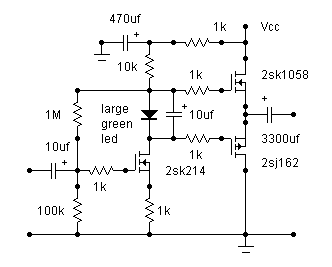

One pair of the Renesas/Hitatchi parts, open loop, has around 1.12A/V transconductance at quiescent and 0.94A/V if one FET is pushed all the way (10V Vds, 8.5A Id and 9V Vgs).
So one pair has around 1 Ohm output impedance, comparing favourably with many open loop tube Amp's, with +/-55V it will dissipate 44W, delivers the "first watt" in Class A (and should not cause major trouble as it slides into Class B), puts out a bit over 100W into 8 Ohm and can handle around 5 Ohm Load (resistive).
I do not see why 8 pairs are needed.
Ciao T
Well 8 pairs might be a bit too much, but at 8 A you need more than 8V Vgs. That can be handled with a separate psu for the input/driver stage, but doesnt such a low transconductance lead to high distortions?
Also, the cgs is not well bootstrapped and you have to deal with a lot of capacity too.

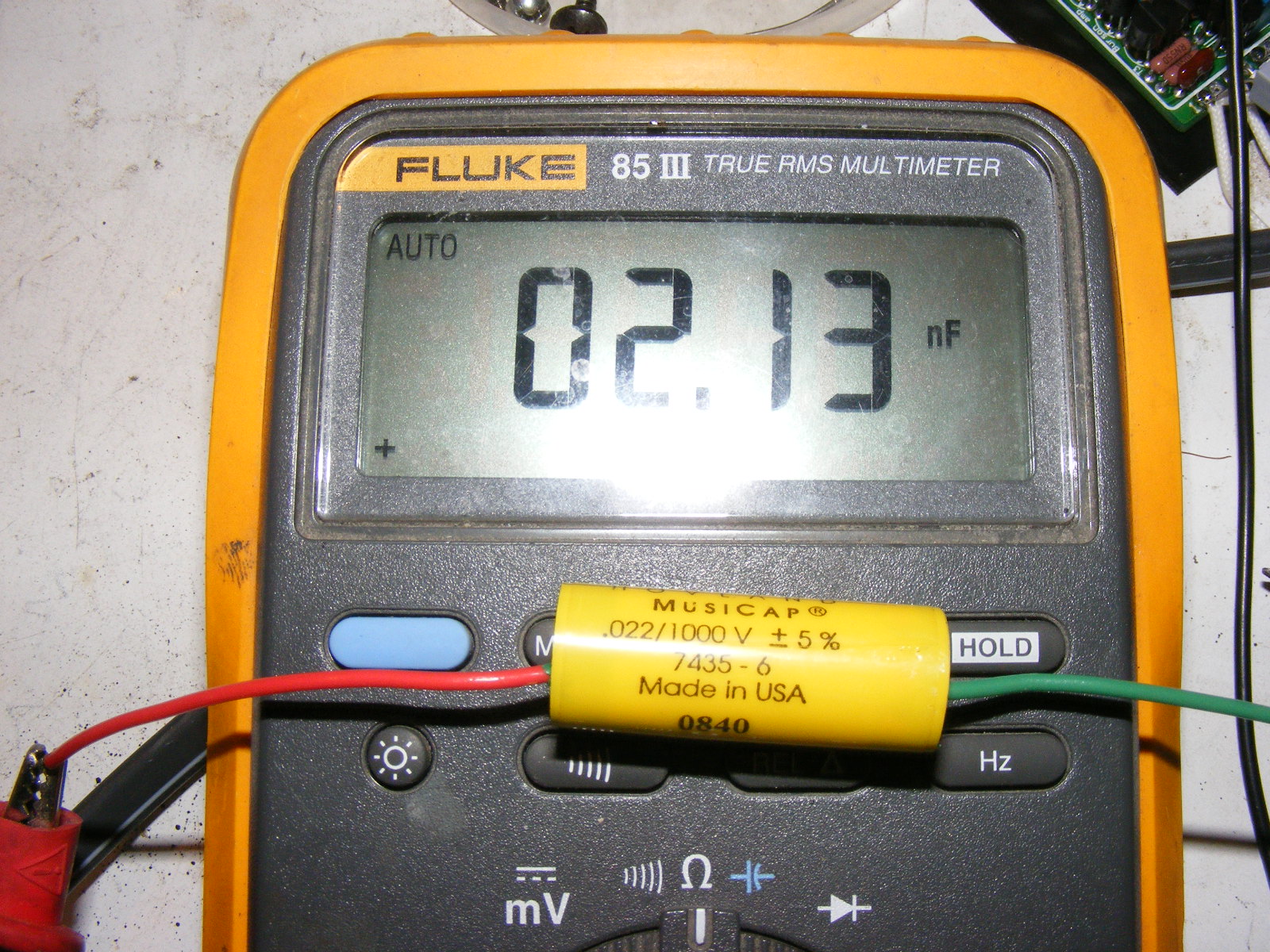

Attached is the picture of the part that caused me to lose a channel of my CD player.
My internet is still not working properly. The "modem" seems to have changed address and I havent yet got it to talk nice to the whole network.
Well, a 300B tube needs 160V PP Grid drive, so what?
I am unsure why you would assume a fairly constant, but low transconductance creates a lot of distortion... I would think that widely variable transconductance causes high distortion, but WTFDIK?
Sure, there is always something to deal with...
If you want to use vertical FET's or even IRF parts, by all means do so and deal with their problems instead. I'm too lazy to try. 😎
