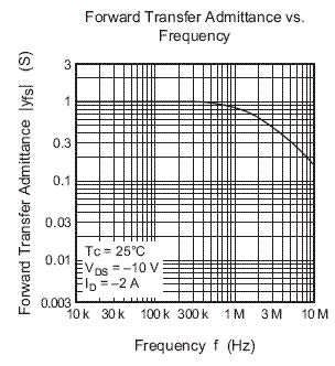

One very important thing that you are overlooking in laterals is that they are quite slow (this actually saves some designers from blowing up their amplifers). The problem is that the structure of the lateral inevitably results in fairly high resistance in the gate structure. Few lateral datasheets show it, but if you look at a plot of gm vs. frequency at a given current, you'll see a fairly low frequency cutoff. I believe I mention this in my book.
For those who know how to use verticals and get the most out of them, laterals are a waste of extra money. This is not to say you can't make a good amplifier out of them, of course.

There is a caveat...Laterals can be safely biased to run quite hot, at around 400mA per device the "wingspread diagram" flattens out nicely, in ways similar to a good Class AB PP Tube powerstage (not straightline, but not bad).
If you want to run the output stage open loop (no CFP also), you'll need to parallel at least 8 of the Semelab single die parts per polarity. Biasing them each at 400mA will lead you to extreme dissipation values.

One pair of the Renesas/Hitatchi parts, open loop, has around 1.12A/V transconductance at quiescent and 0.94A/V if one FET is pushed all the way (10V Vds, 8.5A Id and 9V Vgs).
So one pair has around 1 Ohm output impedance, comparing favourably with many open loop tube Amp's, with +/-55V it will dissipate 44W, delivers the "first watt" in Class A (and should not cause major trouble as it slides into Class B), puts out a bit over 100W into 8 Ohm and can handle around 5 Ohm Load (resistive).
I do not see why 8 pairs are needed.
