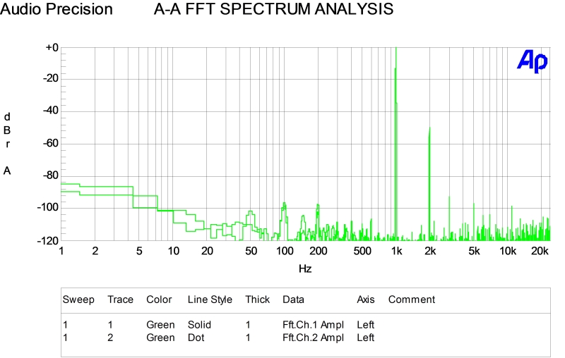

Simon,
The plots shown were 4096 averages of a 32K FFT
Quel Dommage. You build a very noisy circuit methinks.
Below is one of mine.
Single shot 32K FFT, no averaging, output level is around 2V RMS. AP2.
With enough measurements averaged the noisefloor essentially disappears.
It is a compound stage using four triodes, uses both local feedback and distortion cancellation, the 2nd HD could be lower, but it does not sounds as good that way and higher harmonics are boosted that way, so it ended up the way it is.
The room these measurements where taken in BTW, is full of fluorescent lights, all sorts of switched mode supplies, computers and a bunch of really big isolation transformers (they make themselves known in the plot BTW) right behind the measurement place (got to move these one day)...
Ciao T

Simon,
I built stupid simple. Yes it is very noisy!
Put in some effort!
How do you get from the AP to display here?
File
Export as (or some such)
Save as WMF GFX
Open in windows paint
Save as jpg
Open in Photoshop, shink to size (original is 3K pixels wide) , crop to taste and apply any "pen damping" needed... 😀
BTW, what I posted is not "pen-damped", in case anyone suspects...
Ciao T
