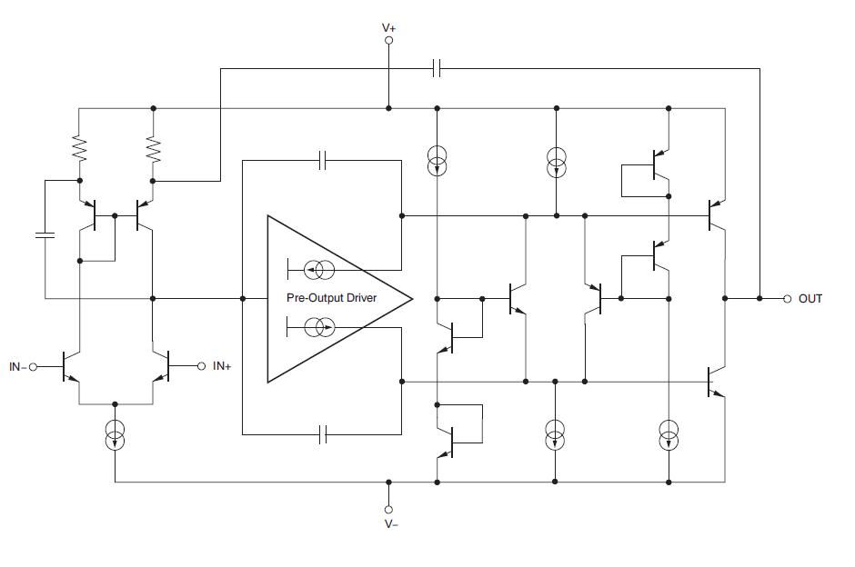

Wow. So you found details about this "pre-output driver" black box?
Do you think that's the secret to the performance?

Charles SY said it, the TI simplified schematic outlines the xDSL style (I think they borrowed it from that group) output stage. You can get that stage to do -80dB at 400mA output current with <1mA bias @1MHz, at audio frequencies who knows. It uses feedback so have at it, I don't get the "sound" of feedback arguments. I don't hear it, that's all plain and simple.
???Do you think that's the secret to the performance?
Charles Hansen asked for circuit details:
You answered:Just as many are interested to find out the circuit details of the Blowtorch, it might be interesting to find out the circuit details of these new op-amps that make everything else "old news". Is there anything you can share with us?
Of course you know that Charles Hansen wanted more insight than just what it's in the datasheet. If you just wanted to make a sloppy comment, you'd better had kept it for you.I found schematics, technical details, and measurements on TI's website.
If not, you may share with us a link.
And he got it. The response from Scott, certainly one of the best-known IC designers in the world, says it all.

The pre-output driver is not that interesting here. What is is the biasing on the output devices, of extra interest is that the output stage can provide additional voltage gain. You will notice the commutation of bias currents top to bottom. This can be arranged so that neither side shuts off (geometric mean biasing). The details are in a patent assigned to National, sorry don't remember the name (see was that Carson, Bill Carson... no it was a C name though I think).

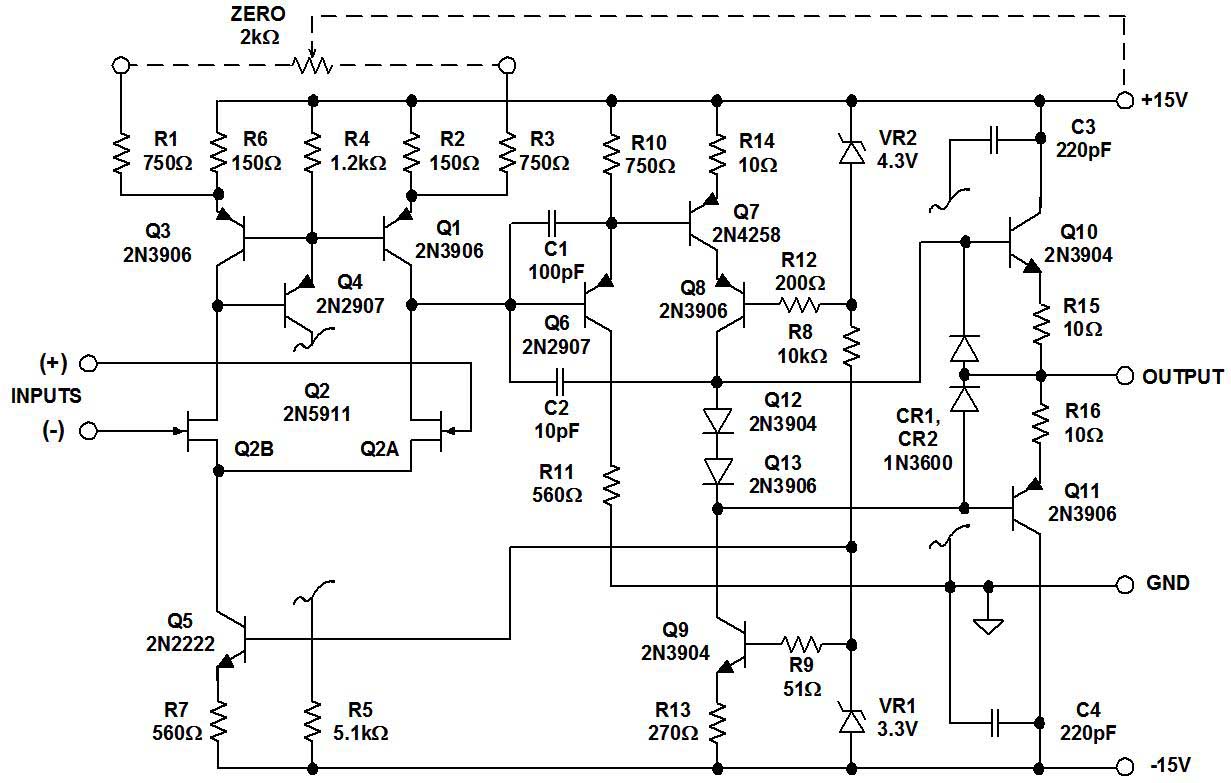

Here's another free one. This is the AD model 50 brick discrete op-amp, one of the best ever work horse amplifiers in the olden days. This is a complete schematic with all component types and values. No guarantee that SK170's will work at the input but BF862's might and would give you a quieter amplifier (though second stage effects might step in).
Now that is an interesting circuit. I assume the current sources are more in the line of mirrors to keep the output swing or is there another technique you can use?
As you are aware gain in the output stage has been around a long time. I seem to think at least '60's maybe earlier, but that was of course discretes.
Thanks Scott. Yes the output stage has gain, as i said above, this gain depends on the load the output sees. The biasing is interesting, less for line level discrete circuits, as they can easily be biased into class a, but rather for power amps.The pre-output driver is not that interesting here. What is is the biasing on the output devices, of extra interest is that the output stage can provide additional voltage gain. You will notice the commutation of bias currents top to bottom. This can be arranged so that neither side shuts off (geometric mean biasing). The details are in a patent assigned to National, sorry don't remember the name (see was that Carson, Bill Carson... no it was a C name though I think).
The current source values are chosen as are the areas of the transistors to set the output bias current (by forcing the output device Vbe). This would be difficult with discretes. This all acts also as common mode stabalization since a fully differential amp would have no mechanism to set the "shoot through" current at the output. The shoot through is hard to control under ALL dynamic conditions, I assure you failure is dramatic (exploding packages).
