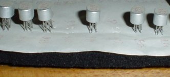

SY's right though, accupuncture is really itchy.
(2 pictures and only 25 lines, impossible to resist.Balloon texts on the next article would be grand)

An interesting variation! I got rid of over 200 little plastic drawers by putting the pages in a 3 ring binder. I use the side of the foam for transistors, by placing strips over divider that has been through my printer for labeling.
