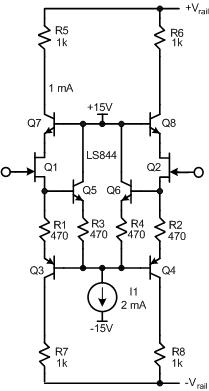

N-channel Complementary IPS
The complementary JFET input stage popularized by John is indeed elegant, but the lack of suitable complementary dual JFETs makes it difficult and expensive to put into products these days. It also requires good JFET matching to achieve its best performance. Fortunately, there is more than one way to skin a cat.
The circuit below is after Figure 7.13 in my book Designing Audio Power Amplifiers. It achieves the same functionality while using only N-channel JFETs. Q3 and Q4 are common-base stages that harvest the source currents of input JFETs Q1 and Q2. R1 and R2 provide source degeneration. The key to circuit operation is to drive the bases of Q3 and Q4 with an accurate replica of the common mode voltage of the input signal. This is accomplished by emitter followers Q5 and Q6 which sum the source voltages of Q1 and Q2 to drive the bases of Q3 and Q4 with the replica common mode signal. Current source I1 conveniently sets the stage operating currents by creating a DC voltage drop across R3 and R4 that is also forced across source degeneration resistors R1 and R2.
Cascodes Q7 and Q8 complete the IPS cell, resulting in cascode outputs to both the top and bottom loads of the cell. Load resistors R5-R8 are just illustrative, and the stage can be used as the IPS in many different complementary architectures, including folded cascodes. The circuit is equally suitable for use in line-level stages and power amplifier input stages.
It is notable that, with the exception of the small base currents of Q5 and Q6, the same current of each input transistor is conveyed to the top and bottom loads, making the transconductance to the top and bottom essentially the same. This is sometimes not the case with the classical complementary JFET IPS because the gm of the P and N-channel JFETs may not be the same for the same operating current.
In fairness to the classic JFET complementary IPS, this stage will often have slightly higher noise, since the classic design effectively places two pairs of input JFETs in parallel and can operate with no source degeneration if so desired. The source degeneration shown in this circuit can of course be made smaller.
