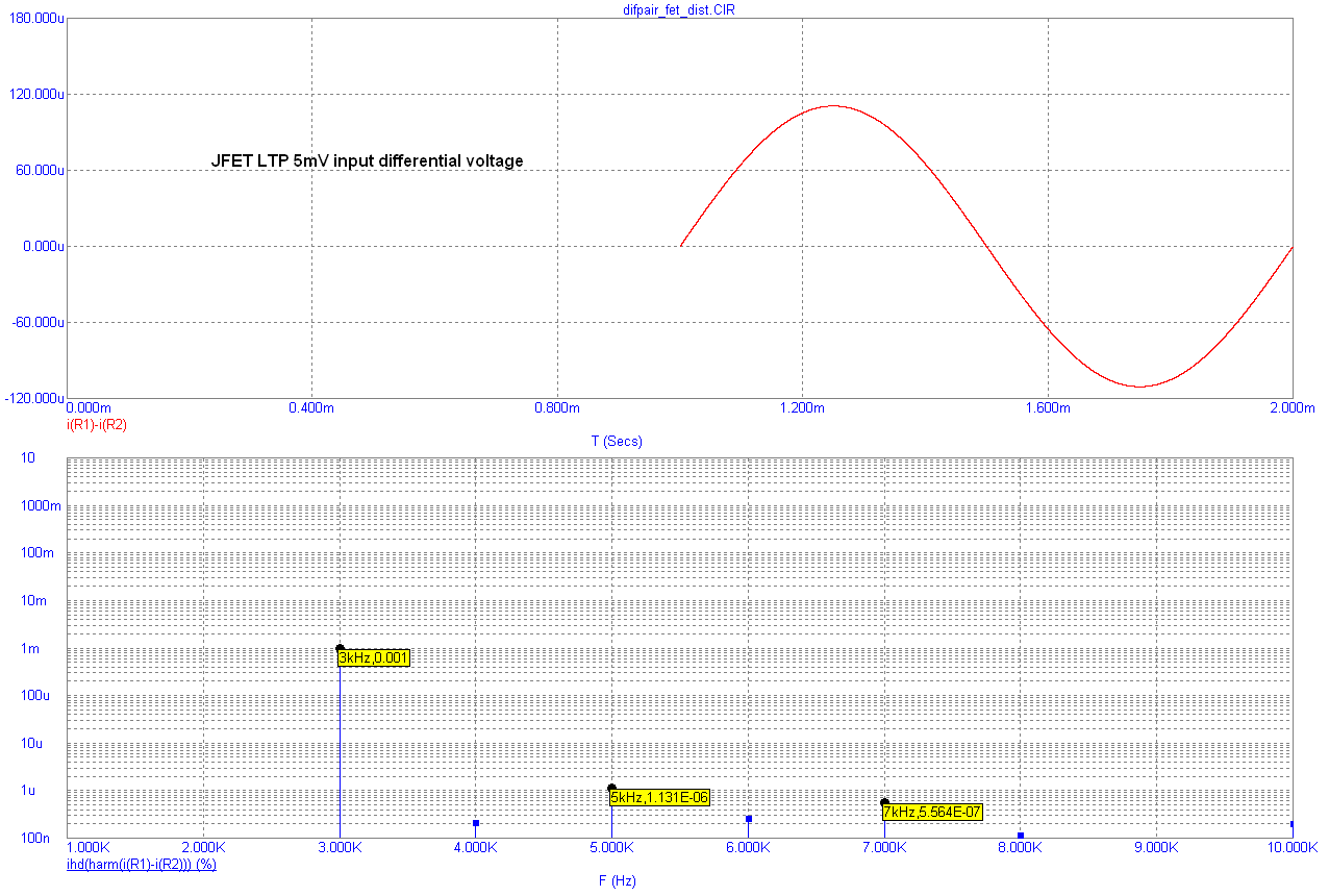

Bonsai, I think you are missing something. First I showed plots for bipolar differential input, voltage 3mV and 9mV at 10kHz. In case you have an opamp with 10MHz GBW and dominant pole -6dB/oct compensation, it will have OL gain 1000x (60dB) at 10kHz. If you have 5V/10kHz at the output of the closed loop circuit, you need 5mV at the input. This is just covered by the 1st plot I have shown here:
http://www.diyaudio.com/forums/anal...ch-preamplifier-part-ii-1265.html#post2592233
, and you can see that the LTP distortion is quite high. If you change input differential voltage from 0mV to 5mV, you will get quite large change in input LTP distortion and Gm.

Wrt PIM, I believe Pavel's tests are interesting. If we take as a realistic value the 5mV pk-pk linear range for the input LTP, in a 100W amp (80V pk-pk Vout) at up to 20kHz I get a minimum required OL gain at 20kHz of (80/5)*1000 ~ 84dB. That seems excessive to me, even if that linear range can be doubled probably with nfb.
My conclusion would be that the avoidance of PIM depends on available OL gain at a particular freq and not on OL BW. Also, nfb or the absence of it does make no difference, as the OL gain and linearity of the basic amplifier circuit does not change with the application or not of nfb.
Is this correct? That 84dB above still bothers me; any comments on that?

Jan, the 'bad' result example is for simple bipolar input LTP.
That means, in case you use more linear input structure, like JFET LTP or multitanh bipolar e.g., you immediately get into much more optimistic mood. Please see the result attached. (Distortion is in %)
OK, but still. Even with an 80mV linear input range you'd need 60dB OL gain at 20kHz to avoid gross non-linearity and thus PIM. Is that realistic? Or are we chasing a ghost? If we exceed the linear range by some amount, how much PIM is actually generated, does anyone have any numbers for that? Walt? Bob?
