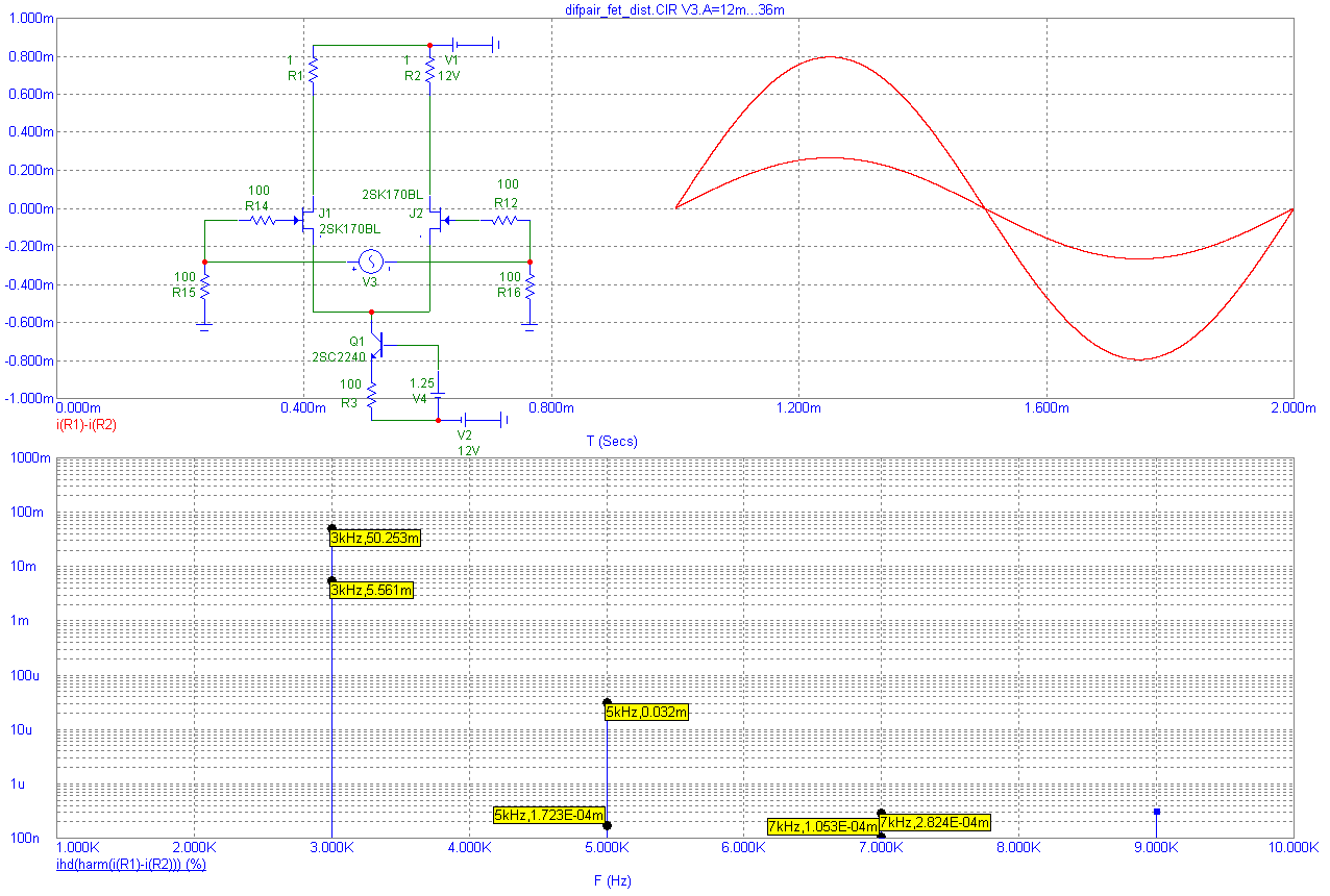

Let's make the same with JFET input LTP. To get same output current amplitudes, we have to increase input differential voltage to 12mV and 36mV. Anyway, we get considerably lower distortion than with bipolar LTP, for same idle current. And we can allow much higher input differential voltage now.

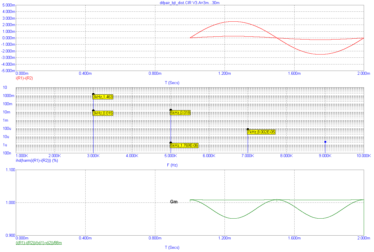

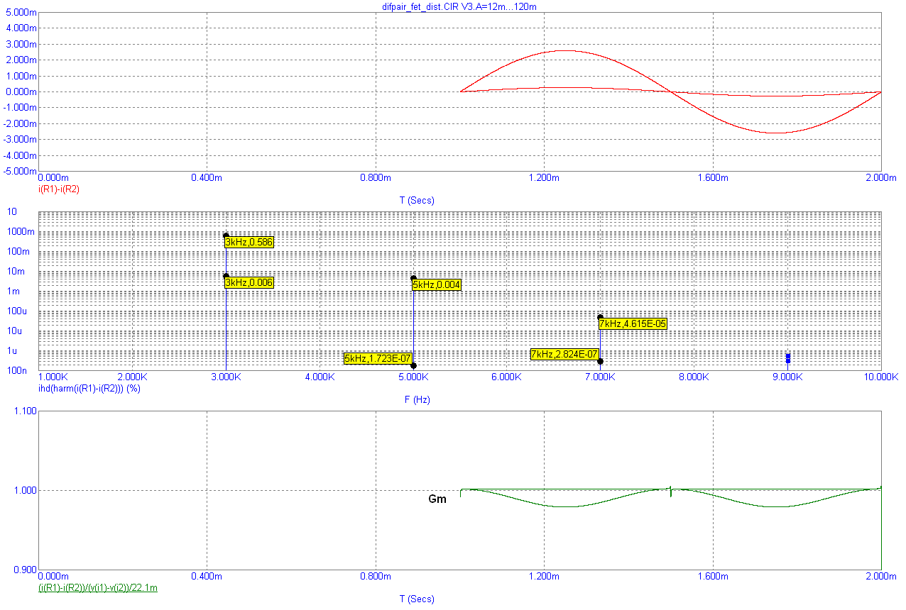

We are also interested in Gm variations with amplitude - this is the key factor. Next two images add normalized Gm (green) for both FET and bipolar simulations. Again, we can see that Gm variations for FET input stage are lower than those for bipolar LTP, for the same idle current and same output signal current.
Good stuff Pavel!

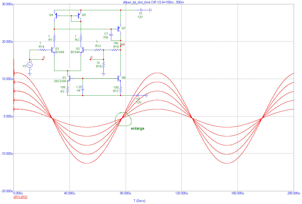

PIM
Now, this is the PIM
In case we explore the LTP without feedback, all the lines intersect in the same point. Feedback converts the Gm variations (in amplitude) to PIM (in time, phase).
BUT, I have to say B as well. This is seen only in a difference of LTP currents, NOT in the output voltage.

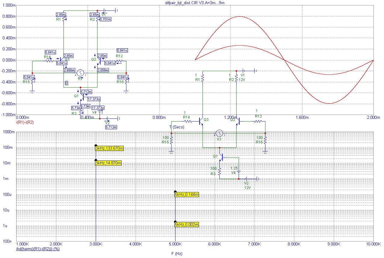

Pavel,
you show plots using bipolar input stages, undegnerated, with high differential input voltages.
In an op-amp with global -ve feedback you are not going to see these large differential voltages on a sine wave input, unless you are above the 3dB corner frequncy - i.e. where there is no longer any feedback.
On bi-polar discrete circuit with much lower loop gains, I agree you will see this problem . . . but then experienced designers would not build an undegenerated discrete circuit like the one you are showing unless the input signal was very small.
Am I missing something here?
Bonsai, I think you are missing something. First I showed plots for bipolar differential input, voltage 3mV and 9mV at 10kHz. In case you have an opamp with 10MHz GBW and dominant pole -6dB/oct compensation, it will have OL gain 1000x (60dB) at 10kHz. If you have 5V/10kHz at the output of the closed loop circuit, you need 5mV at the input. This is just covered by the 1st plot I have shown here:
http://www.diyaudio.com/forums/anal...ch-preamplifier-part-ii-1265.html#post2592233
, and you can see that the LTP distortion is quite high. If you change input differential voltage from 0mV to 5mV, you will get quite large change in input LTP distortion and Gm.

Now consider you have the same circuit, but with JFET input stage. You will again need 5mV input at 10kHz, but then you are far below the lowest curve here
http://www.diyaudio.com/forums/anal...ch-preamplifier-part-ii-1265.html#post2592251
which is for 12mV input. So you get even higher reduction of input stage distortion and Gm variations than I have shown for the same Ic currents of BJT and JFET.
