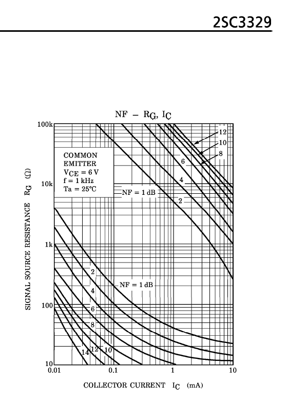

The quietest transistor part pair was made by Hitachi starting about 1978. This part pair was amazing, very low Rbb', high beta, high voltage, and complementary. They are talked about here at times, but jfets are really better for most purposes.
Hitachi 2SC2545,46,47 NPN and 2SA1083,84,85 PNP you mean? Toshiba 2SC3329 & 2SA1316 were maybe a wee bit better even.
