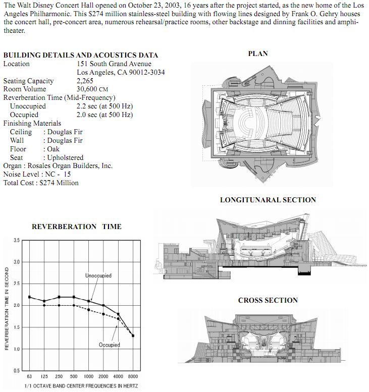

Mariinsky Concert Hall (2006)
same acoustic designers of Disney Concert Hall in Los Angeles (2003) . . .
"Finishing Materials
Ceiling : Douglas Fir
Wall : Douglas Fir
Floor : Oak
Seat : Upholstered"
shows difference in reverberation un/occupied, etc.
Interesting . . . will look for recordings from the new venue . . ..
Wall : Douglas Fir
Floor : Oak
Seat : Upholstered"
