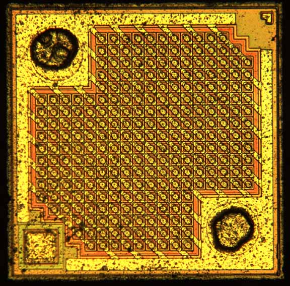

On a Toshiba TO92 jfets Scott? Are you 100% sure about this?No the laser branding appears on real parts (it can't be removed easily). ...
That is really new info for me, at least the J74, J103, J107, J109, K30A, K68A, K170, K246, K366 nor K389, part I have had are not laser marked. at least those from reputable dealers in Indonesia. I am sorry if I made a mistake, but I simply have never seen any original Toshiba TO92 jfets with laser marking.
Do you or anybody else have photo of laser marked original Toshiba TO92 jfets that can be shared for me and others to see and compare before deciding on a purchase?

I've decapped them and posted a photo here. As I said measure them there are no substitutes to use as fakes for k170 and j74 that have the same beta parameter. There especially are no P channel ones or anyone with a comparable process until Linear Systems tried.

It was years ago needs a search.
Oh OK, sorry, i will search by myself.It was years ago needs a search.
Apologies my copy got lost to ransomware. Try the Pass Labs forum or BT thread to narrow it down.
Maybe this one?
George
Here is a genuine 2SK170, lots of tiny FET's in parallel

Yes Scott, I remember reading your post with internal photo of the K170. But I found the fakes they sell nowadays are rubbish. I had several BL J74 with 2.1-2.6 mA Idss at Vp ~ -2V and other odd parameters. Other members in Pass forum also have similar experience. So we advice to purchase the K170 and J74 only from known good sources, the Linear System's from Diyaudio store, member LiubinCalvin, Spencer and Alweit.I've decapped them and posted a photo here. As I said measure them there are no substitutes to use as fakes for k170 and j74 that have the same beta parameter. There especially are no P channel ones or anyone with a comparable process until Linear Systems tried.
I advice to simply avoid parts clear enough in my view to be fakes because parts purchase for testing will still pour good money that will encourage growth of the fake industry. I can only give advice to purchase for testing when the parts look genuine enough.
