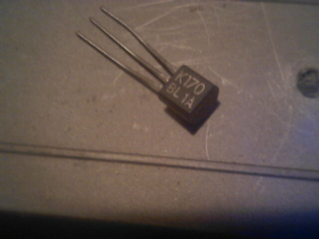

I am quite that this one is fake. Original Toshiba marking is not like that.
Sorry, but not similar enough.Marking looks similar to this :
2SJ103 2SJ103GR Genuine Toshiba Audio JFET @ AmpsLab
Toshiba TO92 jfets were customarily marked by paint based pad printing with 3 different sized font, largest for type, smaller for grade and smallest for manufacturing code which can clearly be seen on the Ampslab's J103. The J74 marking shown previously looks like marked with laser with all 3 marking the same font size, a fake in my opinion.
No the laser branding appears on real parts (it can't be removed easily). I have fake parts where laser branding was faked by hand with Chinese chop carving tools. Many here might not realize that there are many folks well trained in miniature carving in China. The minute inconsistencies in the characters are obvious under a microscope.
I wish folks would stop crying fake on small signal FET's without measuring the basic three terminal characteristics.
