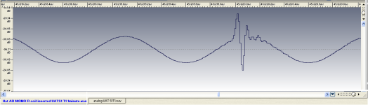

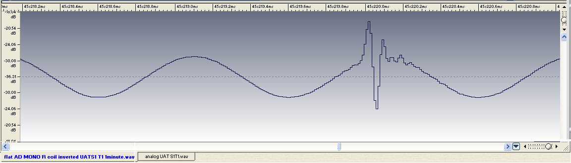

At the attachment you see 1kHz@7cm/sec (lateral mono) read by a Denon DL-103 and flat amplified through an AD620 x53 gain (24bit/96kHz recording).
The risetime for the 1kHz sine is 500usec.
The risetime for this scratch signal is 31usec. This corresponds to 16kHz@14cm/sec, close to the limit of what is possible with vinyl.
If you pass such a signal through the audio system and you record the output at each component output (preamplifier, amplifier, loudspeaker?) you will know where there maybe a problem.
From my vinyl observations, with MM cartridges (2.5-5mV @5cm/s), strong-sharp scratches produce signals with a slope of 0.3-1mV/ns at the cartridge terminals (unamplified-unequalized signal).
Ticks and pops due to dirt may produce stronger output but the signal is not that abrupt as from a scratch.
The worst -in terms of slope- signals I’ve observed, come from static discharging (up to 2.5mV/ns at the cartridge terminals)
