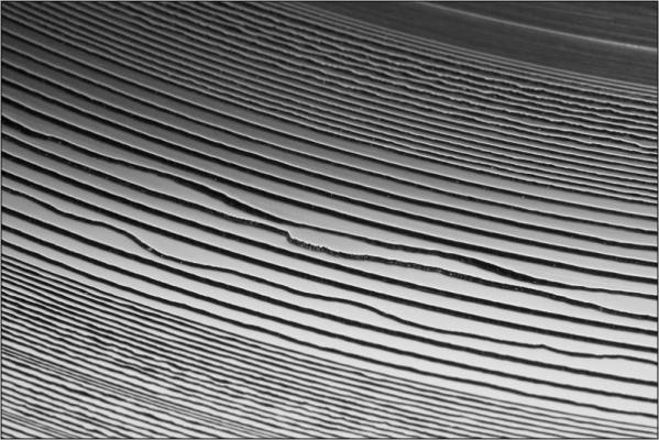

Alone the fact that he has mistracking makes any speculations about risetime invalid.
That means that the setup is not working at all in a gross style, and not that is
has any nice features.
There are few systems/tone arms that can track that 1812 disc.
I recently have published a macro picture of it.
Lesser needles are kicked right from the platter, and the cannons are mostly infra sound.
Now you can speculate if there is any precision left when everything happens
a 1000 or 5000 times faster. Of course, you can just ignore it and stick with
your favorite audio porn. But it has nothing to do with real life.

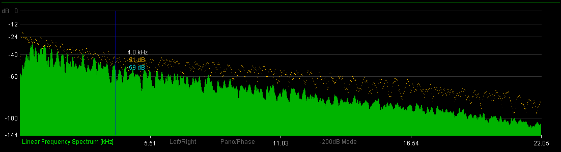

Enclosed is a cumulative and momentary spectrum at 3:43 into the 1st Movt. of the Tschaikovsky's 6th Symphony produced by a well known audiophile label.

Except that the CD sounds thin with shorter decays of overtones.. . . . As JC has stated that 30IPS tape is better than vinyl the CD should still of course be superior. . . . .
Since the XRCD24 version is way better, from your answer I suspect their digitizer for the early CD production is compromised. Thanks.
hmmm 'thin' can just mean it's missing the lovely modulation artifacts that make up the 'warm' and therefore inaccurate vinyl 'sound'. Only those with access to the master tapes would know...
