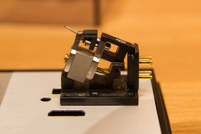

As requested here is the information on the ortofon 20kHz resonance. Now note that there are many resonance mechanisms in a cartridge and I do see some people thinking just about electrical resonance and the cantilever modes. In reality there are many more that can be used if required.
The first mention I can find of this from ortofon is in the 1988 Stereophile review of the MC3000https://www.stereophile.com/phonocartridges/188ortofon/index.html where it is stated
And there have been other changes in the MC-3000. As a result of tests conducted with a panel of "golden ears," Ortofon learned that most listeners prefer a cartridge with a high end rising to 2dB at 20kHz. Accordingly, a rise of that magnitude was designed into the new cartridge.
. If you look at reviews of Ortofon cartridges since then you can see that rise.
The cause of that rise is in the design of the body. Nude Denon 103? shows where a fix for this has been found. I've also attached a picture of same generator without the fix so you can see how the mounting allows for the resonance.
Personally I would prefer to start flat so I could add a shelving EQ if required, but Ortofon MCs review and appear to sell well so they must be doing something right!

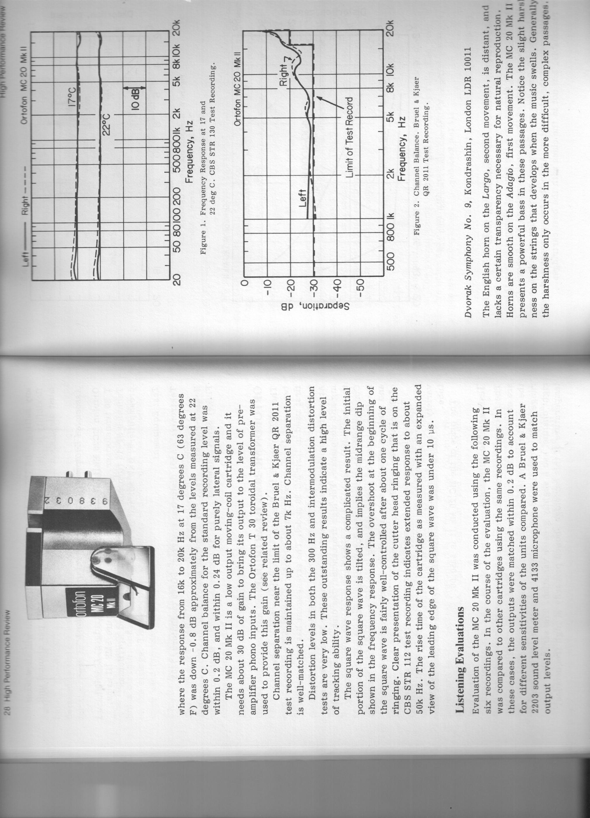

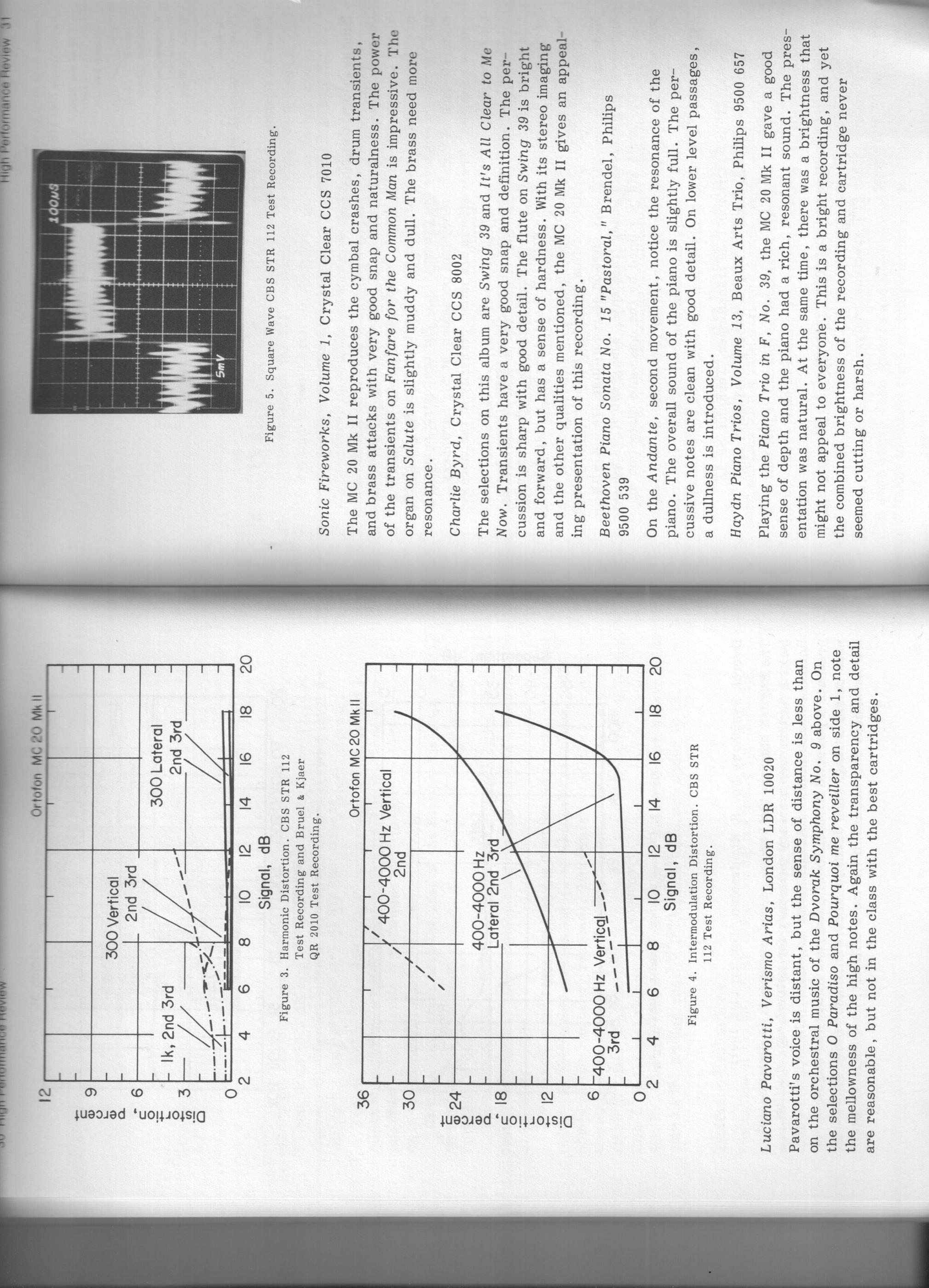

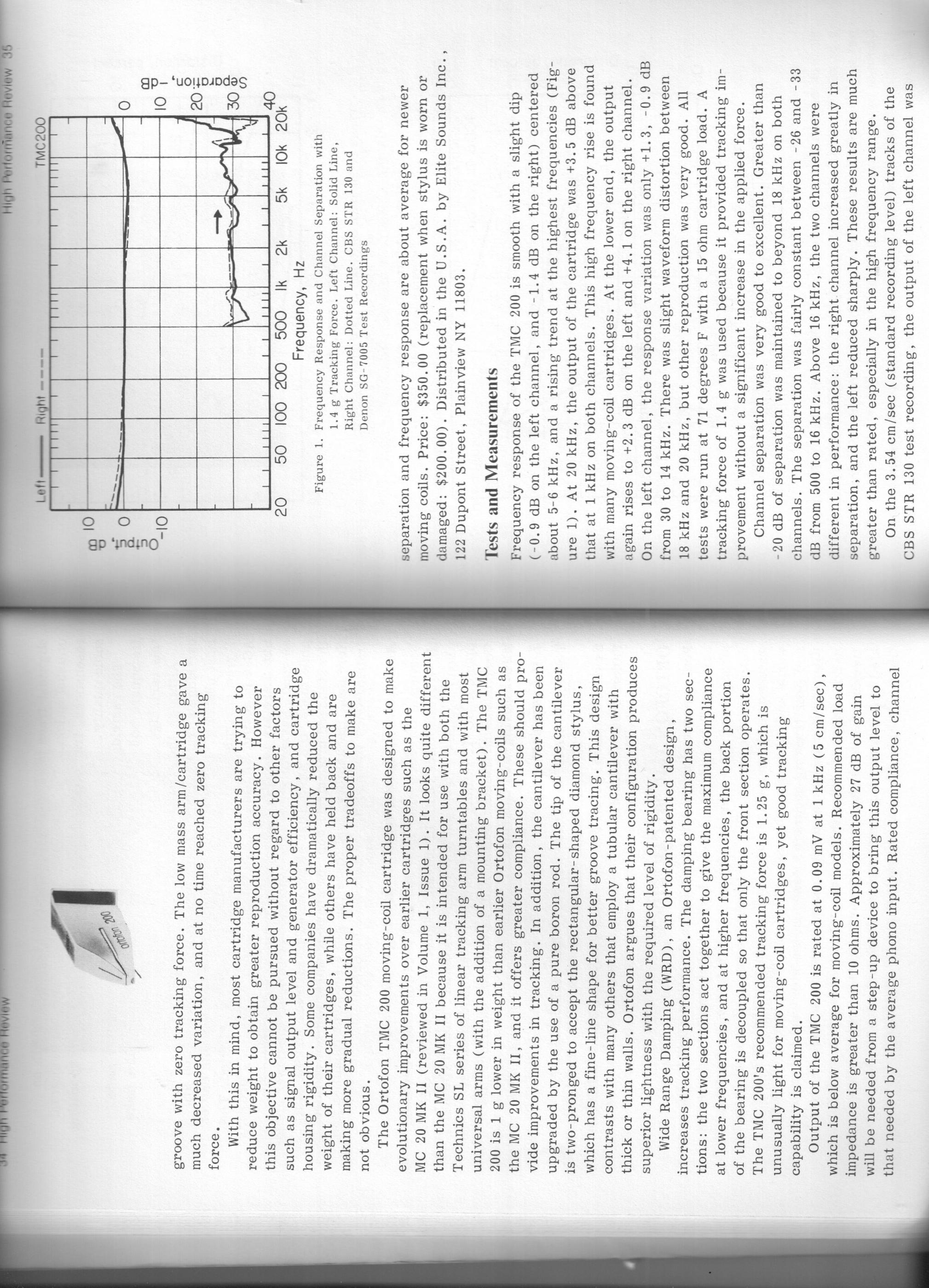

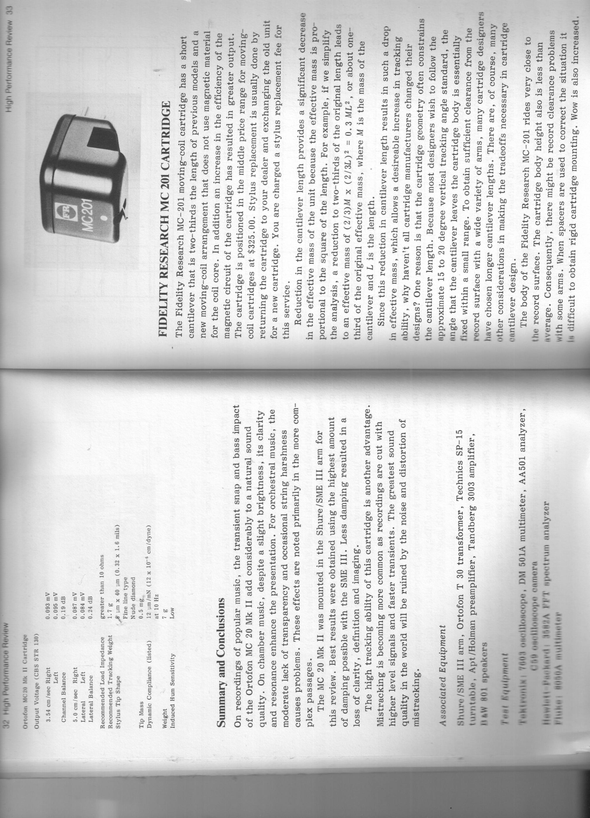

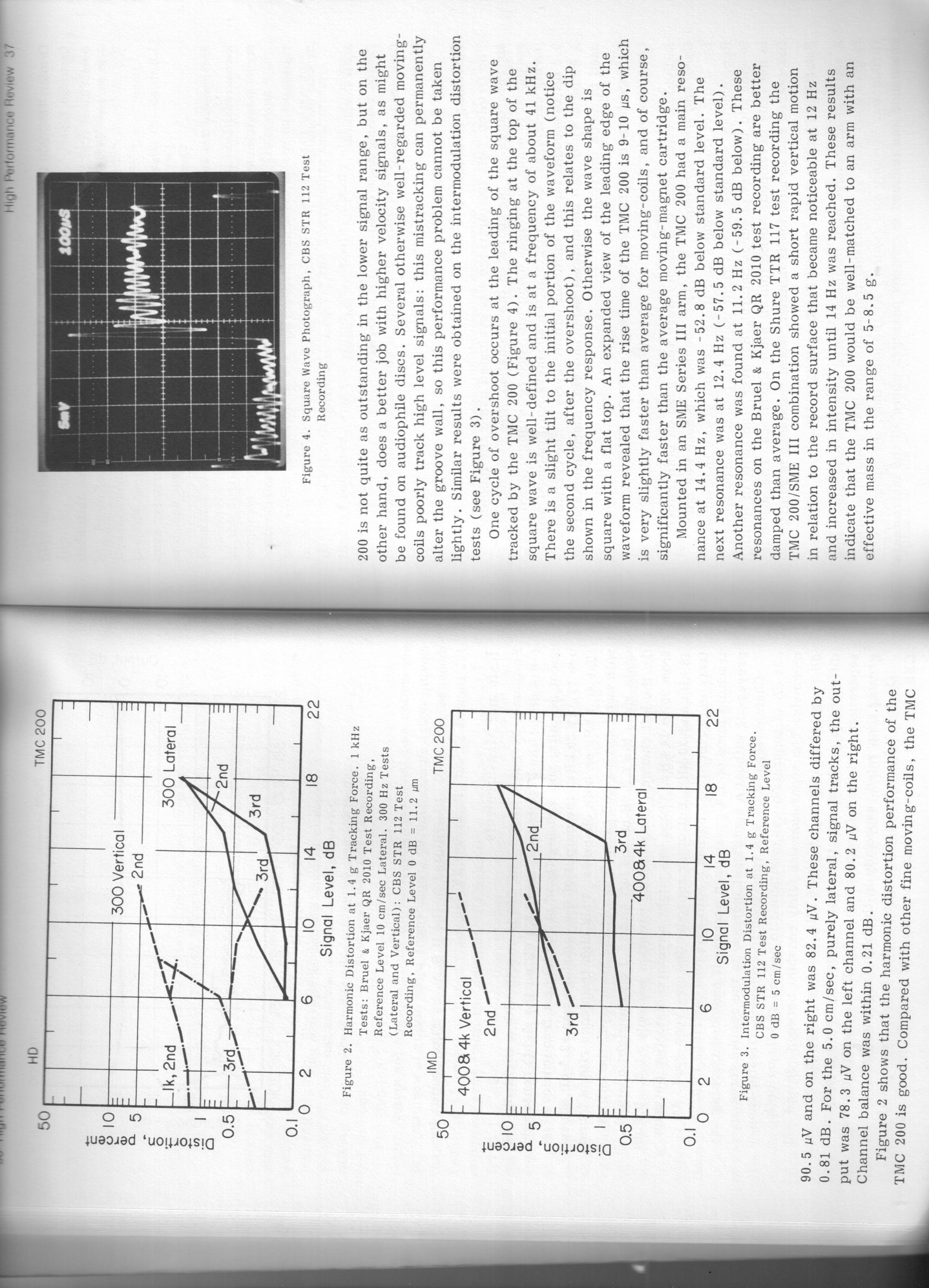

Bill, here is a partial review of an Ortofon MC cartridge that is similar to what you described (rising at 20K+). Real measurements and everything. Please note of the measured response of 40KHz or more. Ortofons have been making MC cartridges that do this for more than 50 years. What is different from this Ortofon MC from most others is that the mechanical damping was reduced so the output rose at higher frequencies. A full sweep measurement would show this better, but we have to use what is available.

I agree. Flat is much preferred. Which (for the millionth time) is why the Dynavector 17D-III is one of the finest transducers available. It is very flat indeed. That said, I see no reference to a peak anywhere in the audible region in the Ortofon. No frequency response graph is shown.
