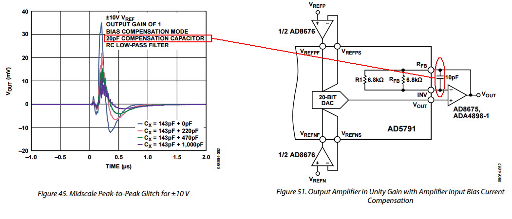

By the way, where is this Cx connected that reduces the glitch ? (see Fig. 45)

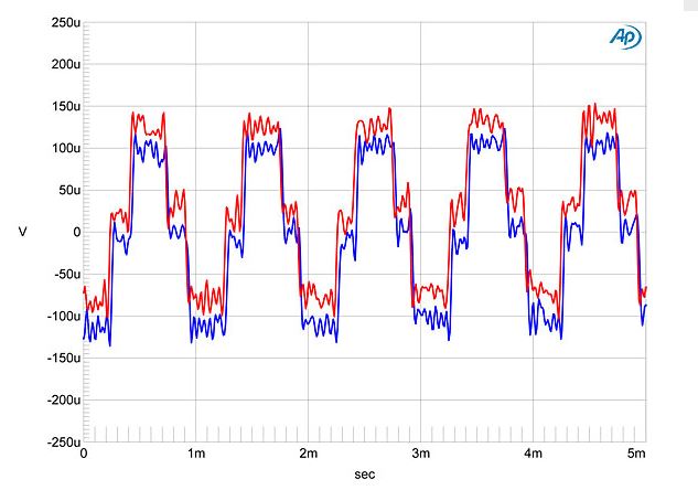

as of the 21st century though, where is the delta-sigma boogy man? The measurements on the CD5004, with its now 14 year old cirrus chip in are superb. Attached image from Stereophile done on their AP shows an almost textbook undithered -90.31dB sine wave. I cannot see a parameter that needs to be bettered for CD playback and I also cannot see anything that the 30 year old 1543 could better in this application.
I can only find a candidate in Fig. 51 as part of the bias compensation circuit.
After you plug your CD80 back into your system, get back to us. I know that when I did, I was stunned.
That capacitor is already mentioned as 20pf in Fig 45.
The Cx maybe an internal capacitor set by the control register through programming. It is not mentioned anywhere, not in the evaluation board instructions, nor in the (accessible) programming info, nor at the Engineer Zone asked questions.

I would have to ask but it looks like there is an internal 143pF and those add ons are standard values hung on some pin. Highly unlikely to have 1000pF on chip.
EDIT - see note 8 on page 4 of datasheet (still could use some clarification).
8 The AD5791 is configured in bias compensation mode with a low-pass RC filter on the output. R = 300 Ω, C = 143 pF.(total capacitance seen by the output buffer, lead
capacitance, and so forth).
EDIT EDIT - George I'll bet it's the standard high cap load drive circuit for op-amps, the 10pF goes directly from output but an R/C filter goes before the feedback via the resistor. The 143pF is the capacitance at that pin?
Very good Scott, I hadn’t seen it.
So what we see in Fig.45 is the result of Fig. 51 implementation with 6kOhm output clamp to ground (through control register programming) plus the hardware RC filter ? (see attachment for RC connection as I understand it)
The question is how Schiit guys have used the DAC (excluding the deglitching circuit).
Subquestions: with or without the output clamping, with or without a compensating capacitor, what compensating capacitor, with or without an RC filter, which RC filter, DAC connected per Fig. 51 or per Fig.53 ?
