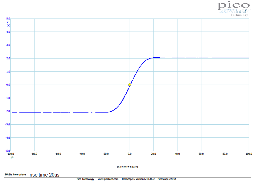

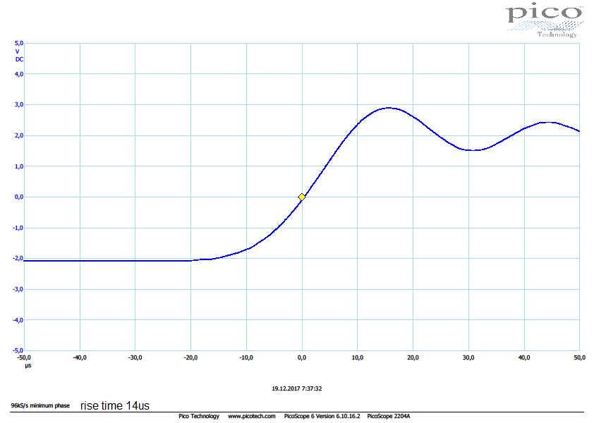

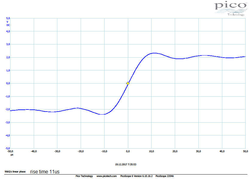

As promised, I did some measurements of rise time on a DAC with proper implementation of digital filters, at 96kHz sampling frequency. The results are as follows:
1) linear phase brickwall filter, Tr = 11us approx.
2) minimum phase brickwall filter (no pre-ringing), Tr = 14us approx.
3) linear phase filter with some decent roll-off between 20kHz and 48kHz added to eliminate overshoot, Tr = 20us approx.
However, IMO the simple rise time value is quite pointless, without more complex info provided. Measurements attached.
