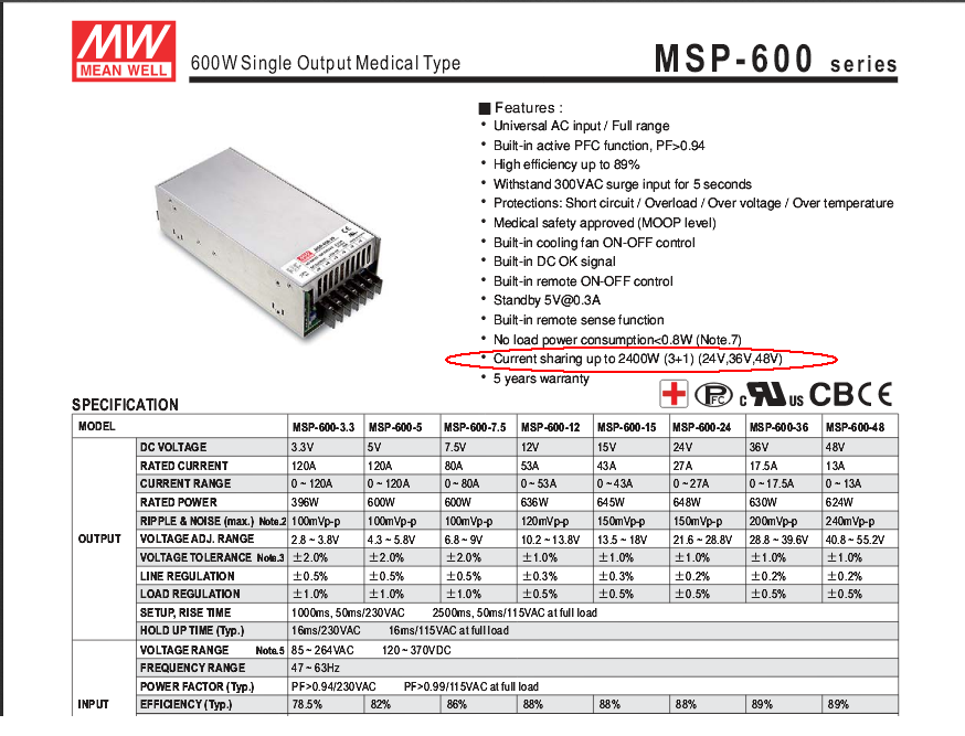

THx-- high quality -- too low voltage and current for PA.

As already said by ticknpop (Mr. Agitator please read the replies to your agitations), series and parallel connection of the floating outputs can provide a good selection from a combination of DC voltages and huge current capabilities (plus there are modules up to 1500W each).
MEAN WELL Switching Power Supply Manufacturer

Yes - lower Z caps at Fo=100KHz would be better... however there is a noise spec. I'll try a spectrum analyzer test on it and see what is there.
Measuring Output Ripple and Switching Transients in Switching Regulators
http://www.analog.com/media/en/technical-documentation/application-notes/AN-1144.pdf
and active PFC which is maintained by the switcher controller itself.
http://www.onsemi.com/pub/Collateral/HBD853-D.PDF
