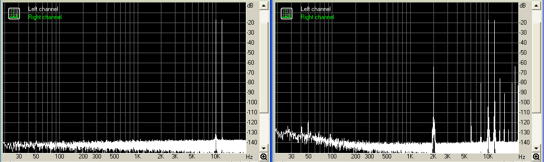

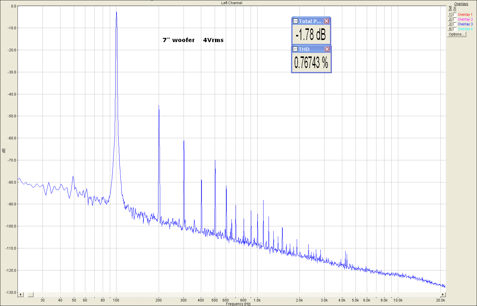

Attached is the 7" woofer 100Hz distortion at 4Vrms. Room and microphone noise not removed, as it would need too long file and noise pattern to be removed successfully at LF.
CCIF IM speaker audibility test:
http://pmacura.cz/speaker10+12k.zip
Pure twin tone vs. recorded at 5.66Vp. Room and microphone noise removed.
Audibility of the previous 100Hz/4Vrms shown may be tested at
http://pmacura.cz/speaker100.zip
Please feel free to post a positive ABX result, it would not be easy at all. Please do not use small PC speakers which would suppress the 100Hz frequency due to their LF roll-off.

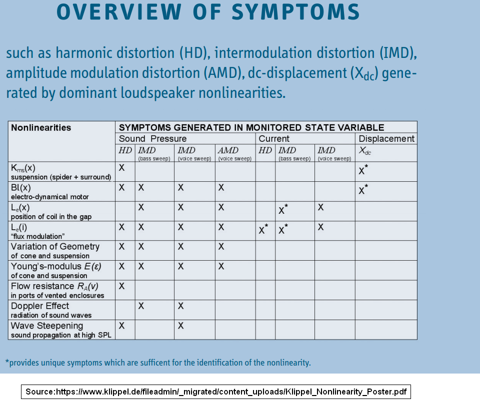

As Pavel said, plenty and very analytical material at Klippel site (and don’t fall into the trap of extrapolating beyond the test data range, unless you 100% trust the mechanism’s theoretical model)
Separated loudspeaker distortion
Application Notes
George

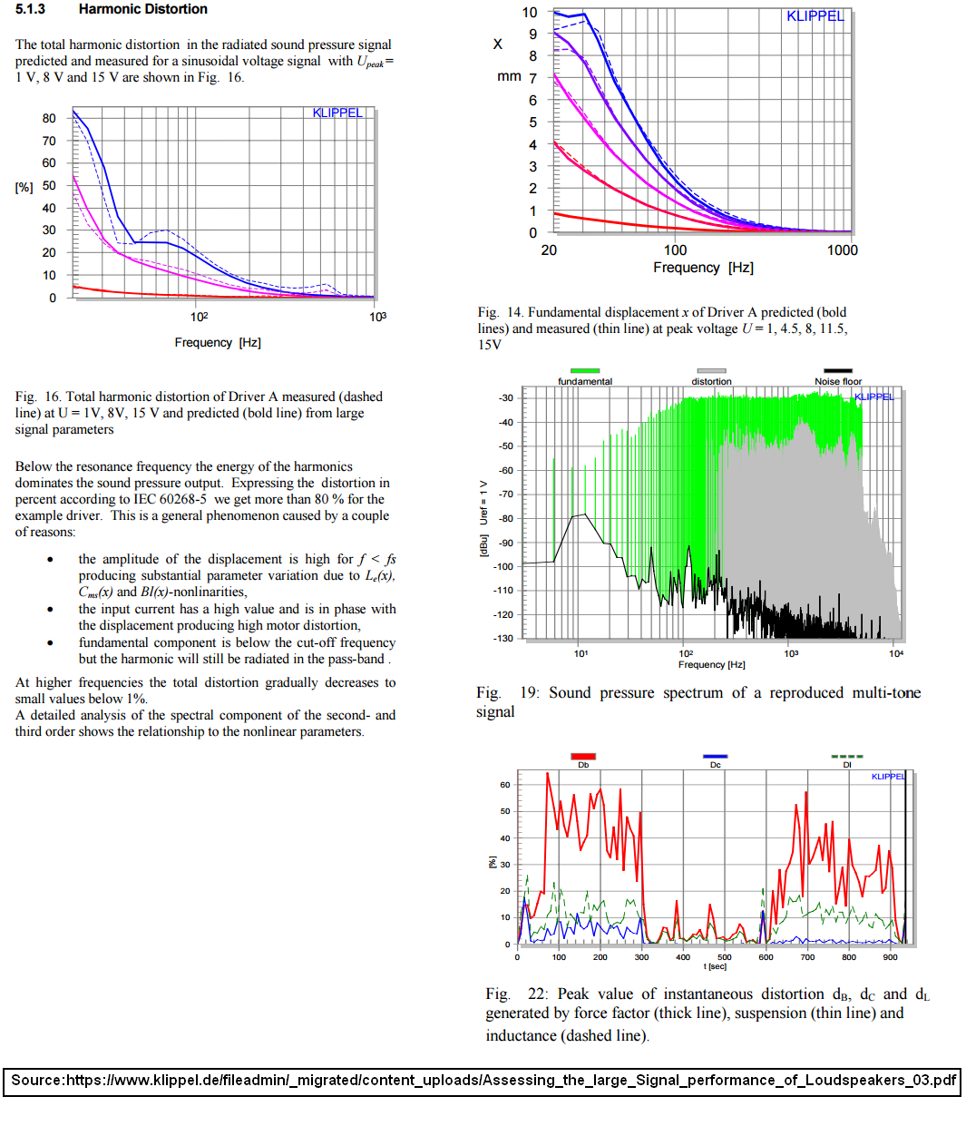

Have you gone through all those papers? This is just from one of them
https://www.klippel.de/fileadmin/_migrated/content_uploads/Assessing_the_large_Signal_performance_of_Loudspeakers_03.pdf
George
George

George: once again thanks for the link. Out of context that graph seems to be a case of 'no sh*t sherlock'. Below 100Hz we all know that distortion goes up if the driver is operating outside it's core parameters?
Credits go to Klippel (Richard functions as an agitator here)
It is shown that most of the large signal distortion is due to force factor (Bl(x)).
It seems that the combination of a high BL and a small overhang is the root of the step increase of distortion with cone displacement. (I see that with 8V signal level, the max specified displacement has been achieved at freq lower than Fs (30Hz)).
I quote some paragraphs:
The example driver is an 8 inch woofer with a relatively high force factor as shown in Table 1. This corresponds with a short voice coil overhang causing an early decay of the Bl-product at small displacement as shown in Fig. 5.
(Fig.18) Both the measurement and the prediction agree in substantial distortion which is constant at about 40%. This is typical for motor distortion caused by an asymmetry in the Bl(x)-curve. Intermodulation distortion of this magnitude is clear audible as a roughness of the high-frequency component. The intermodulation due to the Le(x) nonlinearity are at a constant level of 1 % at higher frequency. The Doppler distortion increase by 6dB/octave to higher frequencies and come up to 10 % for f1= 2kHz. The intermodulation distortion from Cms(x) are less than 0.1% at very low frequencies and may be neglected at higher frequencies.
(Fig.19) There is an almost constant distance of about 15 dB between fundamentals and distortion components for the example speaker shown in Fig. 19. Again we see that the asymmetry of the force factor generates high amount of distortion ( > 20 %) when a low frequency bass tone with high displacement modulates any high frequency voice tone. It is typical for this kind of speaker distortion that the intermodulation are close to the voice tone. Above 5 kHz where the multi-tone signal provides no excitation the driver produces much less distortion ( < 1 %) because only harmonics and summed-tone intermodulation between high-frequency fundamentals are generated. Again we see that the harmonics are not the most critical distortion in loudspeakers.
Fig. 22 shows the contribution of each nonlinearity as the ratio of the peak value of the distortion referred to the total sound pressure output. Clearly, the force factor is the dominant source of distortion for all the three music examples. It exceeds 60 % in the first piece where the peak displacement is about 10 mm. The distortion from the voice coil inductance are about 20 % in first and third music piece but less than 10 % for the second piece. The nonlinear suspension produces more than 15 % distortion in during the first piece, less than 0.1 % during voice section and about 2 % distortion during the last music piece.
Notice in section 6 and in Fig 24 what a dramatic change in D2 would be achieved by correcting the voice coil offset (Fig. 23 shows the problem of this driver).
