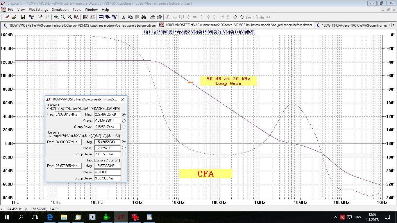

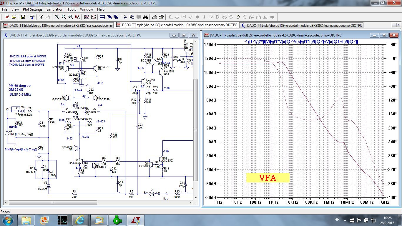

Absolutely no problem. And do not take into account just only dominant pole frequency compensation (-20dB/decade behind OL corner), you may get 60-80 dB loopgain (feedback factor) at 20kHz and still keep your amp well stable.
VAS loading and flattening OL frequency response has the only effect - higher distortion. Though we speak now about inaudible distortion levels.
In both amp types is possible to get 80 dB or more loopgain at 20 kHz with special type of compensation.
Closed loop gain in both cases is 28 dB.
