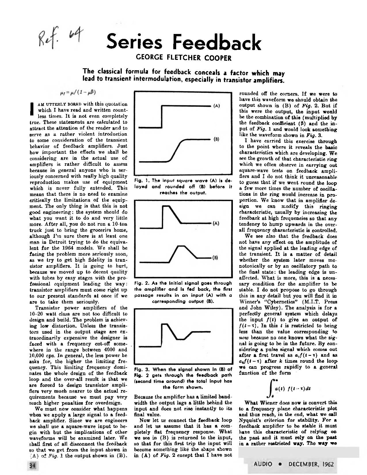

Let's discuss it! Remember, this is before personal computers, almost before computer aided design, and even before silicon transistors became popular. In the early days, graphical techniques were often applied to get a better understanding of an electrical problem and this is an example that, at least to me, is quite revealing.
This could still apply to many circuits used in audio today.

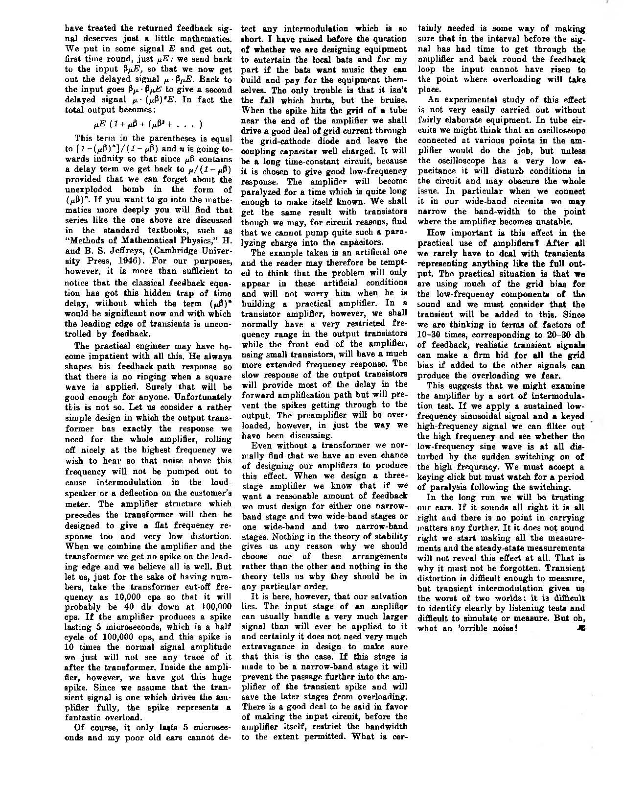

Poking around on my computer, I found this article from 'Audio' magazine that is almost 55 years old and is almost a revelation in insight to the negative feedback problem, yet done so long ago---before Otala, Jung and just about everybody else who has had concerns about the secondary effects of negative feedback. Let's discuss it! Remember, this is before personal computers, almost before computer aided design, and even before silicon transistors became popular. In the early days, graphical techniques were often applied to get a better understanding of an electrical problem and this is an example that, at least to me, is quite revealing.
Totally wierd, the first page is missing many letters in Sumatra pdf reader? what is going on, is it a corrupted download, or does anyone else get that too?

I believe the PDF JC posted is what they call image with text. OCR may have been used to embed text data in order to allow copy and paste, or for speech synthesis. Some PDF readers may not fully support the format, or sometimes video drivers can cause problems depending on layers.

Cooper's paper insists that all amplifiers using series feedback MUST exhibit overshoot when driven with square wave inputs. But I and many others have built amplifiers whose open loop phase margin is 80 degrees and whose closed loop square wave response exhibits no overshoot at all. This is not even difficult. For a quick one-hour proof in the lab, connect up an externally compensated opamp as a gain-of-plus-ten noninverting amplifier, and choose an external compensation which gives more than 83 degrees of phase margin. Suitable candidates are the NE5534A {the single, not the dual} , the LM301 , and others. Ain't no ringing there, mister.
