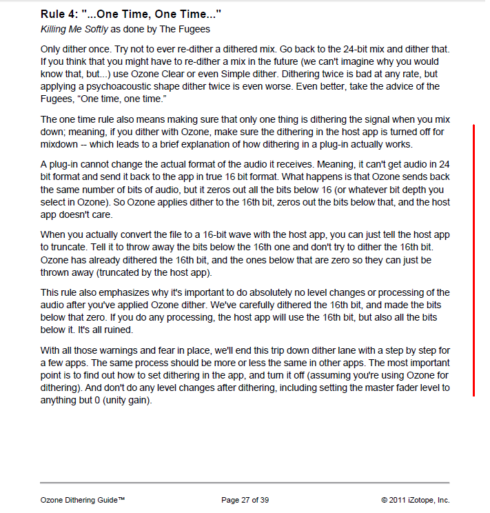

You got me thinking about it some more. Of course, it's just a result of adding, say, a 24-bit number representing the signal with another 24-bit number representing dither which happens to be all zeros below bit 16, for example. Not the same as adding two 16-bit numbers, which would be the case if dither were added after truncation.

I think it becomes obvious when you realize that the damage has been done to the noise floor already from truncation, adding dither after the fact only "obliterates" (decorrelates?) the noise below the noise floor of that particular dither. The spectral lines above the dithered noise are the same as before dither was applied, as you would expect from a signal, which it is now.
You are talking about the ‘truncate first then dither’, yes?
I agree. And I think that jcx words find a place here:
add dither noise at the level you intend to truncate at to "whiten" the quantization noise from the following truncation step
and the order definitely matters, truncation is a nonlinear operation and dosen't "commute" with the dither noise addition step
proper application of dither doesn't just "mask" the quantization noise correlation with the signal (the modulated hissy, spitting sound of musical note fades) it destroys the correlation altogether (up to the 2nd statistical moment anyway seems to be enough for hearing)
I think that for the ‘truncate first then dither’ case, dithering only masks the part of the (correlated with the signal) quantization noise which lies below the dither noise peak level.
While for the ‘dither first then truncate’ case, dithering effectively reduces the correlation of the quantisation noise with the signal at least to the extend that the quantisation noise spectra components are reduced to a level at and below the peak level of the dither noise.
The Ozone Dithering Guide emphasizes the necessity of using the ‘dither first, then truncate’ procedure when dithering and truncation are discrete processes. See page 27 “Rule 4” and the subsequent step by step instructions for a few apps (hosts) to which Ozone is a plug-in. (pages 28-38)
George
Jan you're missing a not so subtle point, going 24bit to 16bit the TPDF function's magnitude is in 16bit LSB's not 24. The noise floor for any type of dither is computable in the simplest case of TPDF it is slightly more than the 16bit quantization noise so you must raise the noise floor of the 24bit file to that. BTW when creating pure mathematical examples sometimes the ceil() and floor() functions for rounding give very slight differences. This animation is not bad YouTube
As for George's plots only the two with flat noise floors are proper applications of dither. The others are flawed some quite obviously with a couple obviously doing nothing.
OK, I got it now. And I see Mark and JCX make essentially the same point, thanks guys.
