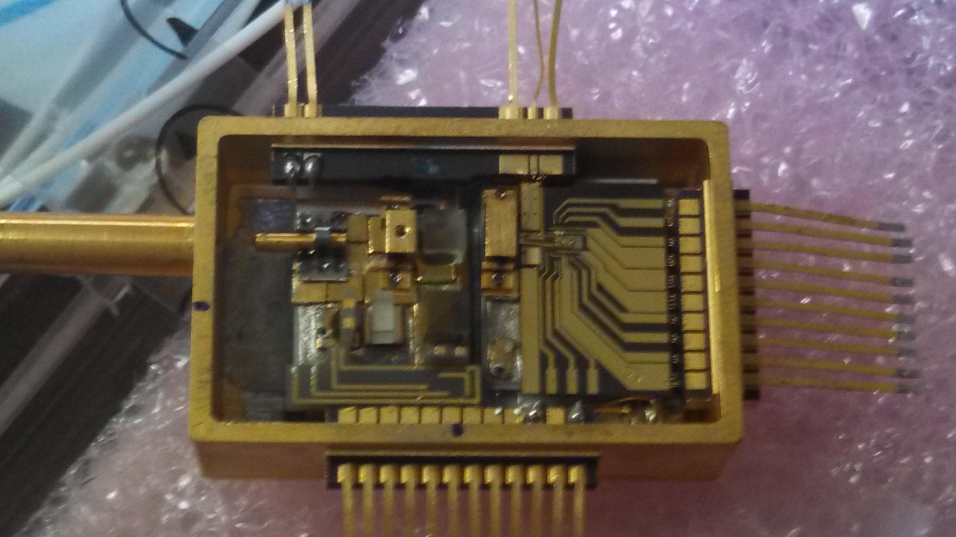

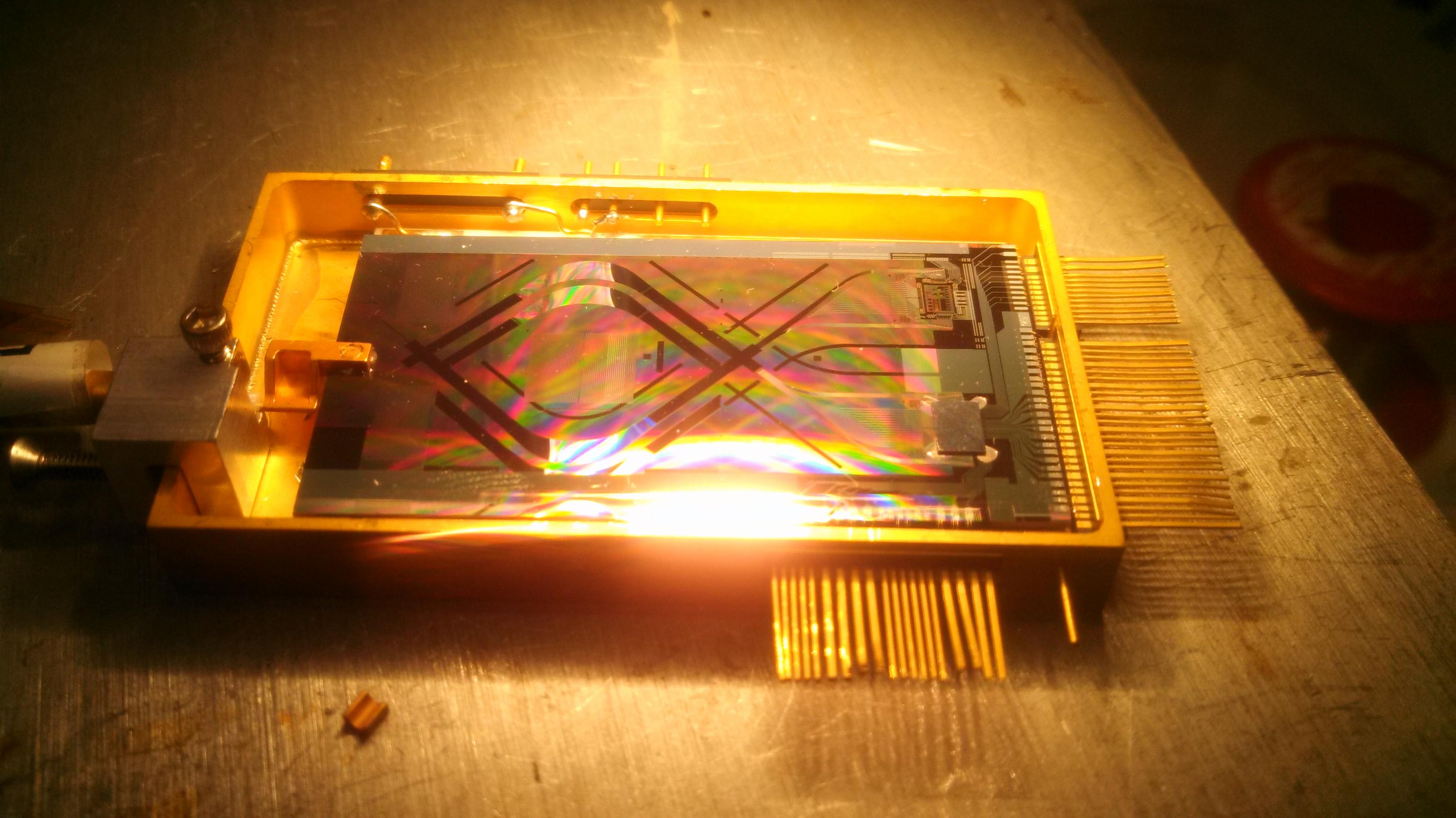

Gerhard, Remember for most uses the fiber lengths are fairly long, with short lengths, 1-3 m and if using terminated fibers, you have back-reflection problems unless you go for expensive termination and fiber polishing schemes and use sources like DFB. VCSEL's are not immune to back-reflection problems. In the Corning device, a silicon waveguide is used circumventing the back-reflection problems at the wave-guide fiber interface.
Now how do the get the VCSEL into the waveguide? Do they use a well and mount it on its side, Do they P-Down mount into an angled reflector? Are they using a newer hybrid VCSEL? The most elegant was I know of had been patented by a small company. They bring the waveguide to the surface of the silicon substrate and evanescent field couple via tightly controled
P-Down bonding.
