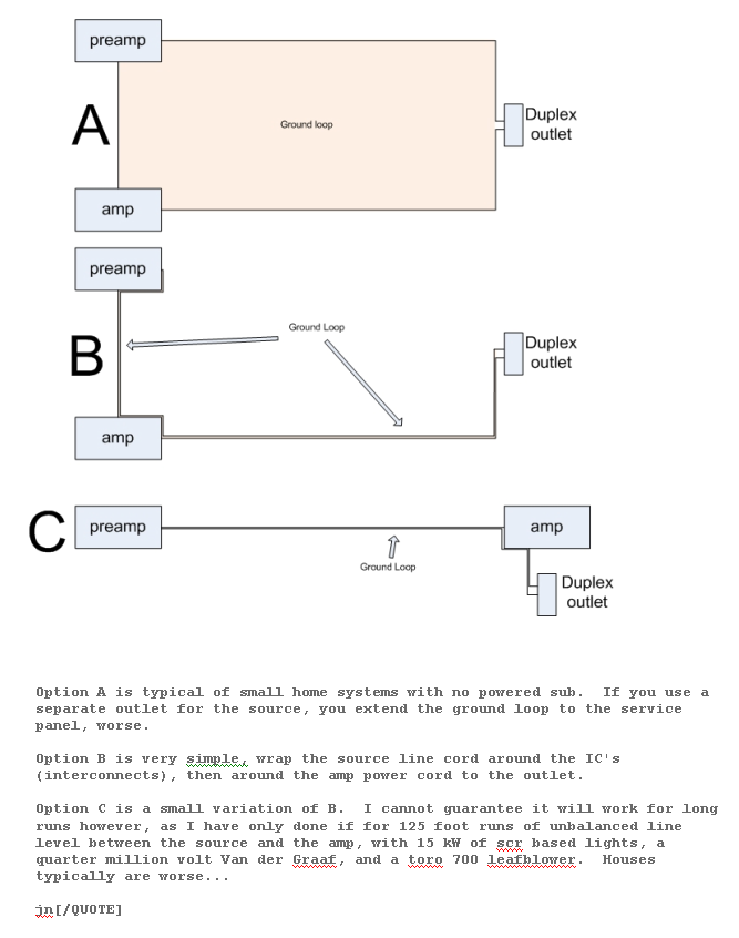

Yeah. funny how things like 'good engineering practice' get ignored when there is flooby to discuss. Ideas like class II sources, balanced lines or transformers where there is a measurable gain get ignored. Too sensible?
Again and again I see in front of me the truth of Jneutron suggestion.
It is not the dirt of the PE ground that increases noise, it is what it is picked up by the loop(s) formed by one of the PE ground conductor and from any other PE ground conductor and/or shield of the unbalanced signal interconnects.
Reduce/minimise this loop area by routing all power cabling and all interconnects held tightly together.
... are correct 🙂. The idea is to minimize voltage drop created by interference current flowing through one of the signal conductors, which is, in case of typical RCA SE link, the signal ground return (shielding or anything else that serves as a signal return).
George: The habit in UK of a ring main, so all the equipement is inside the loop may not be the most sensible. An audio spur may after all be a good idea!
