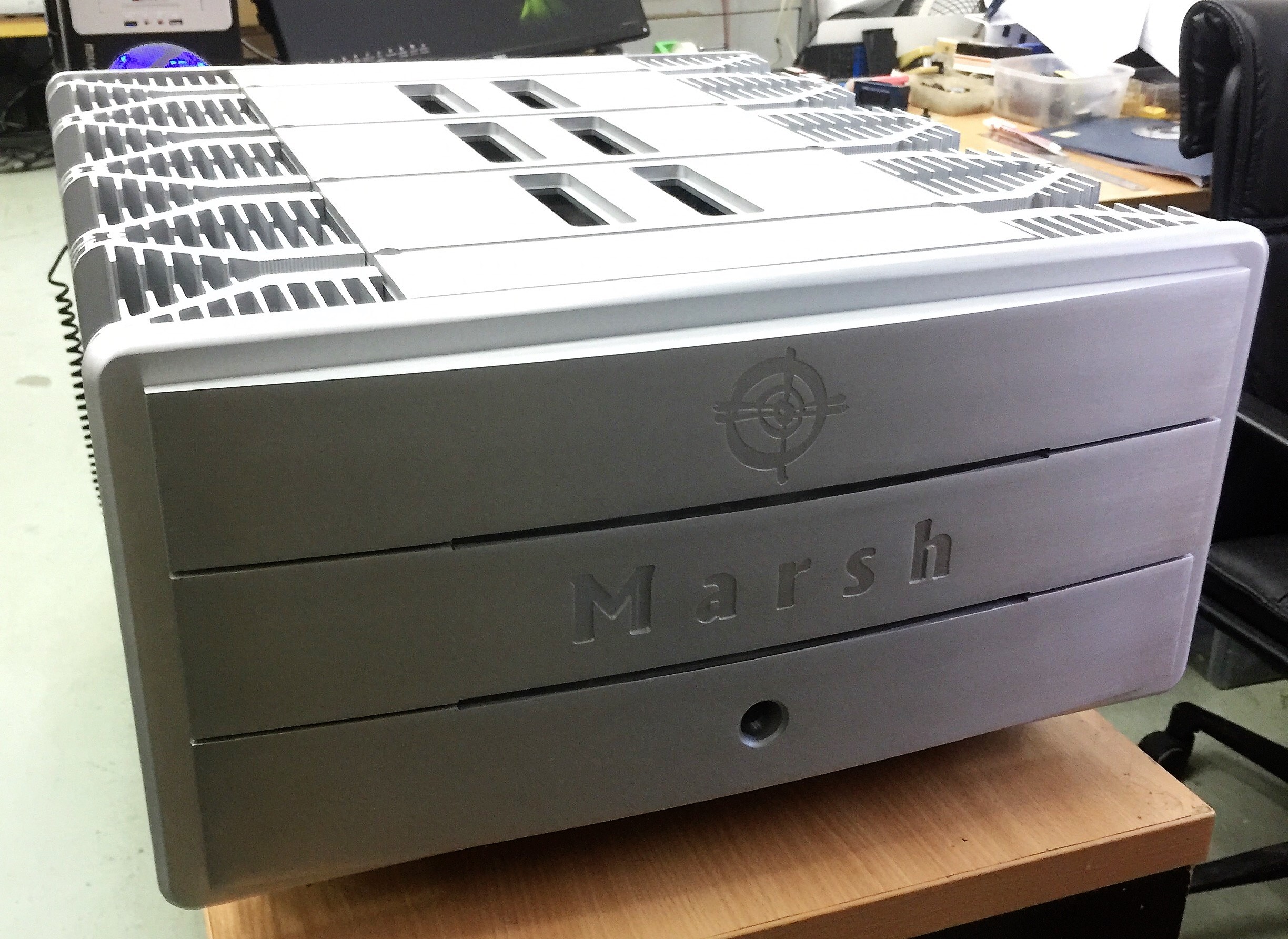

The ultra high quality chassis for my amp with circuit designed by Dadod --- its fit and finish and milling all done....
My crew makes a great chassis only for great circuits.
Congratulations!
How much is it to advertise in a magazine?
Mono and Stereo High-End Audio Magazine: NEW MARSH ULTRA HIGH END POWER AMPLIFIER
depends on a lot of factors... one time or 6 times or 12 times a year... discounts.... then location... front inside cover or back. full page or partials... color or B&W, small B&W in the back pages is lowest, etc.
Note: MARSH and logo are reg brand name in Asia.
-RM
-RM
