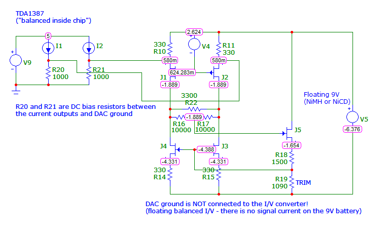

The baxandall might need a capacitor between wiper and non-inverting input. And the non inverting input is biased with a 22k to ground on the TI schematic. So the wiper current is significantly increased compared to Putzeys circuit.

Alexandre: You realise you are committing heresey presenting a circuit with so many nasty 8 legs in and not an obsolete FET in sight 🙂
Yes... I have to say though, that I really like the jfets in my I/V converter (used with current output DACs). I have tried a few classic multibit dacs with basically the same jfet stage and I have had excellent results. I´m not saying it isn´t possible to get it right with opamps, but I prefer not to make changes to a winning team. They work wonderfully well in common gate.
This is not the exact one I am using but I might rebuild it more or less like this (I borrowed Scott´s common mode servo):
