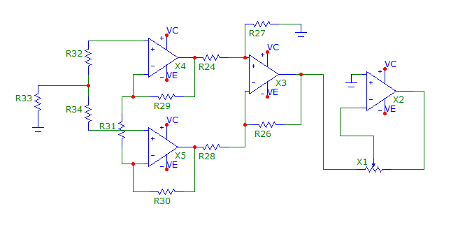

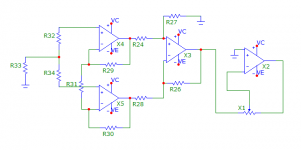

I re-read it and fully understood this bit of the Putzeys balanced preamp article.
"Long story short. Instead of operating as an attenuator, the potentiometer is used as the sole feedback element in an inverting amplifier. Linearity of the volume control now only hinges on the linearity of the divider ratio. This is almost guaranteed in linear pots. The track resistance can be very very nonlinear before this becomes an issue."
What he means is that despite the slight non-linearity of the track R (resistance will change as a function of current flow), the divider ratio doesn´t change in this particular circuit, because the current is the same through both portions of the track that constitute the resistive divider (there is no current or very little through the wiper, microamps or less).
In other words, there is a slight variation in total track resistance with signal, but this R variation does not affect the programmed gain. Divider ratio is constant with signal. No trace of compression or expansion (which one is it with a carbon track?) with large excursions.
All of this is valid for a linear track. Don´t use log or you will completely muck up the goodness of the circuit!

The reason for the switched resistors wasn't for better sound, but for better (perceived or real) ease of use.
In the original circuit, turning the pot to one extreme moves the gain towards infinity. Could be scary ;-)
The switched thing lets you avoid that.
OTOH, I am using one of these preamps with the linear dual pot for more than a year now and never had any user issues. At some point it is loud enough and that is it. But I don't have any small kids running around either.
