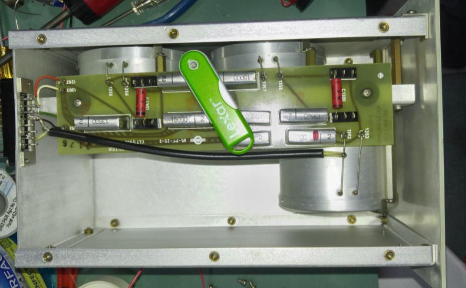

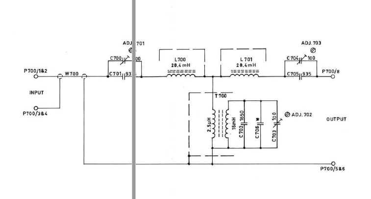

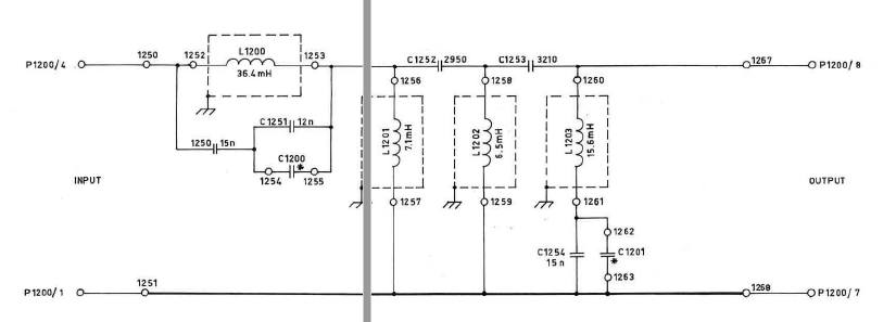

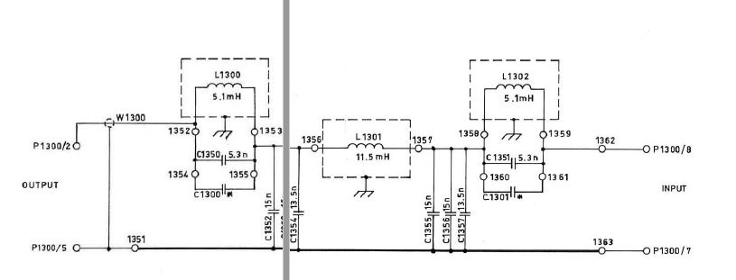

Attached is a picture of the CLT-1 low pass filter. You can see the three coils inside their aluminium cans. I believe there are ferrite pot cores inside. The USB stick is for scale. This filter is tuned to remove the third harmonic of a very clean 10 KHz sine wave with up to 1W passing through. For a 1 KHz filter I guess the coils will be 10X the size?
In the CLT-1 manual they say a lead pencil tip next to a lead wire can cause harmonics.
