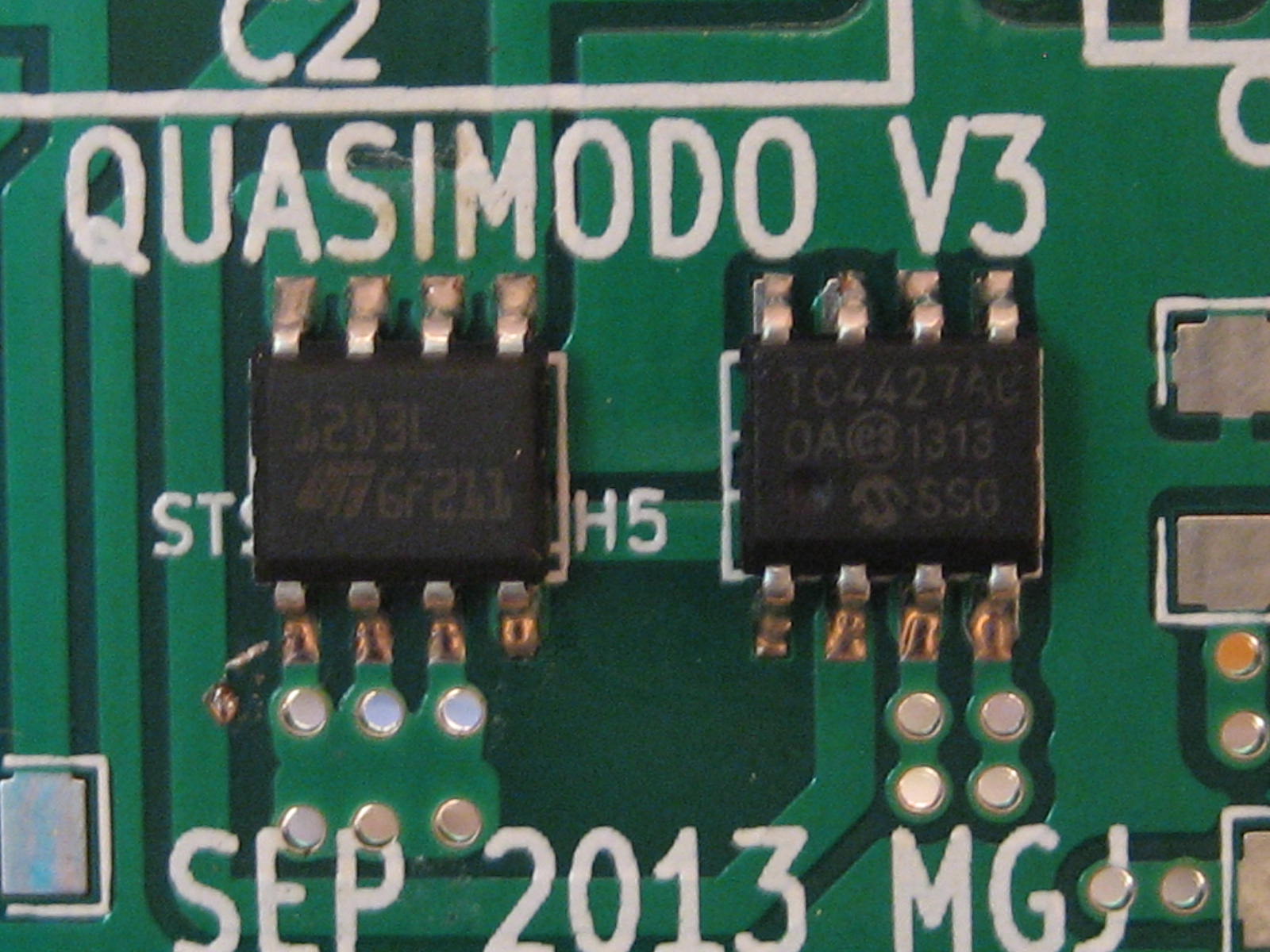

Quasimodo - Good pics with better callouts that mine, as I tried to put
a background box around my text but program wouldn't'cooperate.
Is that Mark Q. Johnson?
