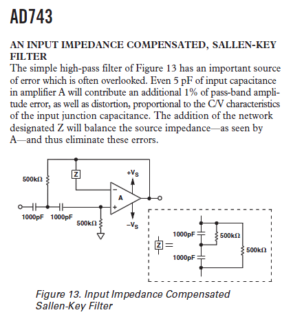

Which topology for a low-pass filter would give the least thd/harmonics from the opamp used, on the output?
The one with the least common mode at the input. . .
Are you saying that a Sallen-Key LPF (which includes an opamp configured as a +1 gain buffer) can be improved by yanking out the +1 gain buffer stage and replacing it by a cascade of two inverting amplifiers, each with gain -1? Assuming opamp GBW is way way higher than the highest signal frequency of interest, etc, etc
I have not seen a Sallen key filter that did not have a distortion issue from the common mode. Cap upgrades make no difference. Its most severe at F0. I guess you could make one with two cascaded inverters and the feedback to the second stage. There are opamps with less common mode distortion that may help.

what I am looking for are topologies which will have lower harmonics at the output ---- lower than the opamp used --- above -3db of the LP filter. I have some ideas but maybe there are better ones out here/here.

Seems to me you'll probably have to accept a higher output impedance vs frequency curve, than the bare opamp @ gain = +1 provides. So how high is too high?
whole thread on point for op amp CM distortion: http://www.diyaudio.com/forums/anal...impedance-jfet-input-op-amps.html#post4120385
my posts show a couple of composite op amp options to improve common mode (input impedance modulation) distortion
also indirectly mentioned: http://www.analog.com/media/en/technical-documentation/application-notes/742022599AN232.pdf
Scott mentions Z balancing at +/- inputs, shown in his AD743 ds to reduce the CM distortion

I had to do something, the 743/745 have 50pF input capacitance to the substrate to get the noise (no free lunch).
I've seen the same network in the B. Hofer's presentation "Designing for Ultra-Low THD+N in Analog Circuits".
Now I know the source.

Bruce and I are old friends, he came to ADI decades ago on business and insisted on meeting me. I was flattered and honored beyond words.
I can't find this piece of information on the datasheet! Did ADI omit it, accidentally or purposefully?

Some opamps are good enough to have lower distortion non-inverting. Just use those if you worry about it.
The input impedance spec is there, my memory might be wrong it says 18pF at 15V Vs maybe it was 50pF at 5V. The point is that it was not insignificant and the circuit suggested made a big difference.

inverting mode does virualy eliminate input CM nonlinearity, but at some level any op amp will have other distortion - likely from AB output stage and falling gain at high frequency
there are no perfect op amps - with monlithic at some performance level you simply have to go composite/multiloop/bootstrap and possibly Class A biased output
with composite techniques, using multiple op amps for one gain/function block it is possible to drive audio frequency distortions deep into the noise floor - audio frequency active filters then limited by passive components performance
