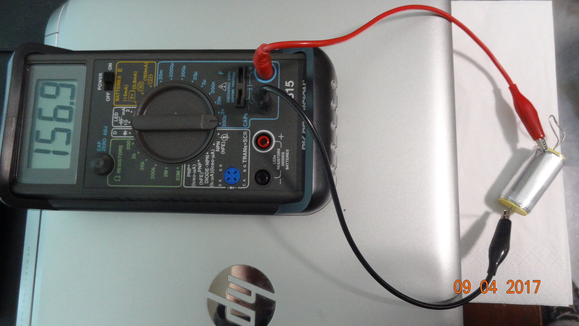

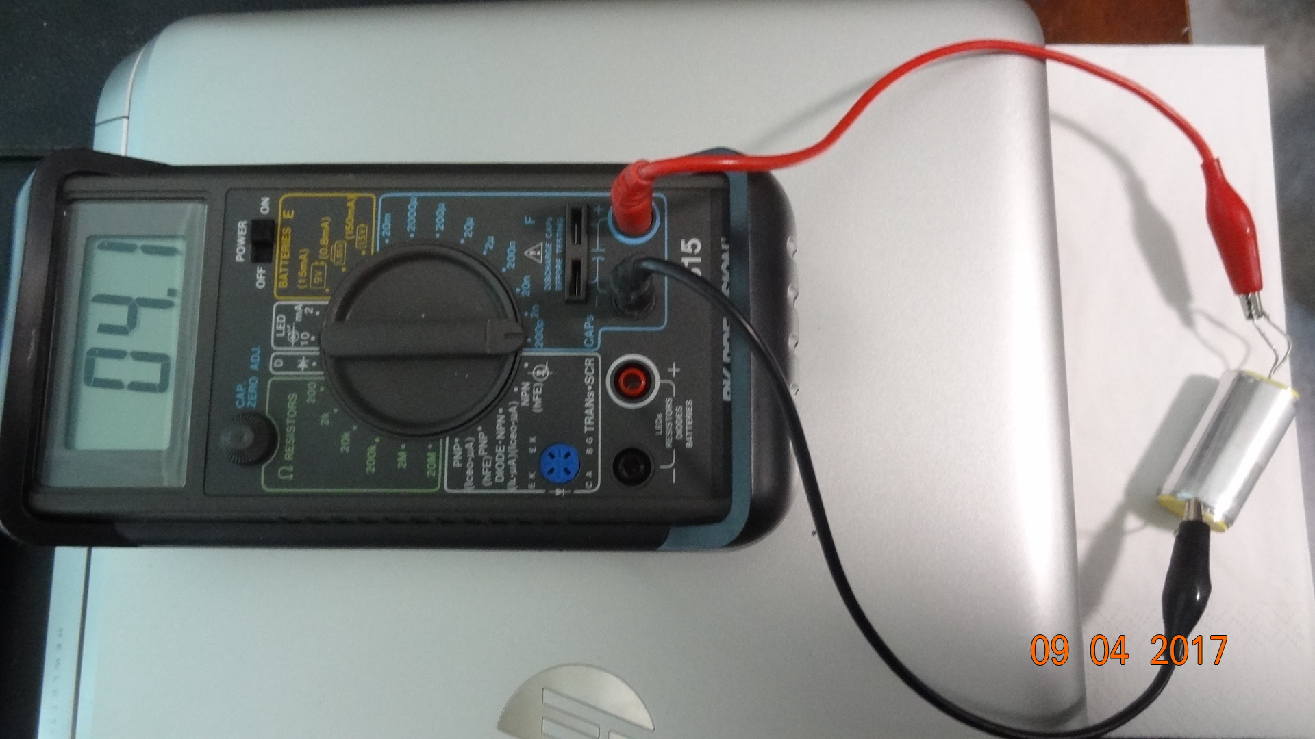

an example... to find the ground side or outside foil-lead -----get some tin/alum-foil from the kitchen and wrap around body of cap/DUT:
I'll let the pictures do the talking.
![DSC02906.JPG DSC02906.JPG](https://www.diyaudio.com/community/data/attachments/557/557532-6058c282d08489da00638d16f90c83db.jpg)
![DSC02907.JPG DSC02907.JPG](https://www.diyaudio.com/community/data/attachments/557/557540-b15201784706671dcd7f4874eac977bc.jpg)
THx-RNMarsh
QUOTE=gpapag;5046427]Thank you Richard
George[/QUOTE]
![up :up: :up:](https://files.diyaudio.com/forums/images/smilies/up.gif)
If one is careful to zero out the c between leads and not move the leads more than a fraction of an inch during tests, there is a distinct different. Notice, my meter has the zero feature. And don't have the foil go over/past the cap ends.

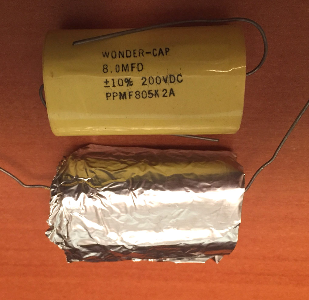

8.0 uF 200V WONDER-CAP purchased from J. Peter Moncrieff / IAR
183 pF: tinfoil to cap left lead
191 pF: tinfoil to cap right lead
photo attached
If you are careful in c measurement, it would be the right lead which is the outer foil.
In a few circuit applications, one could also use copper foil or tin and solder a wire to it and ground it... for a shield.
-Richard

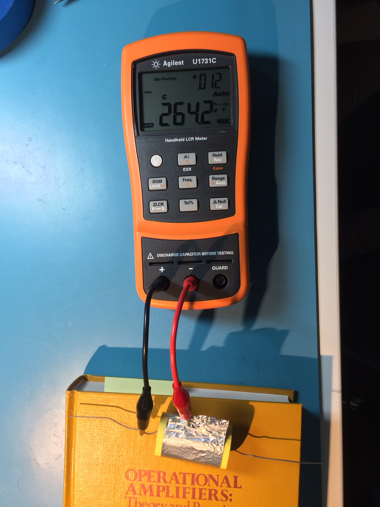

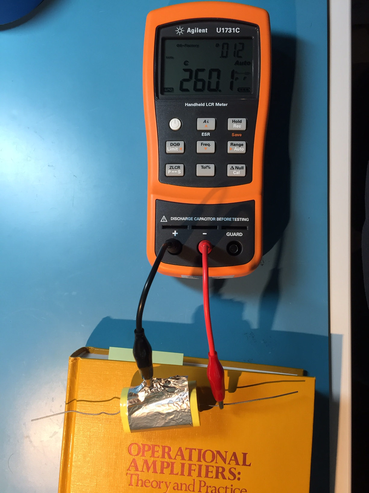

Dug out the Agilent LCR meter with zeroing feature (they call it "Null" , it's the keypad at bottom right) and trimmed the tin foil. Same IAR WONDER-CAP 8.0 uF 200V capacitor.
260.1 pF foil to cap right
264.2 pF foil to cap left
images below. BTW waving the leads around a few inches, changed the displayed capacitance by 1-4 pF.
