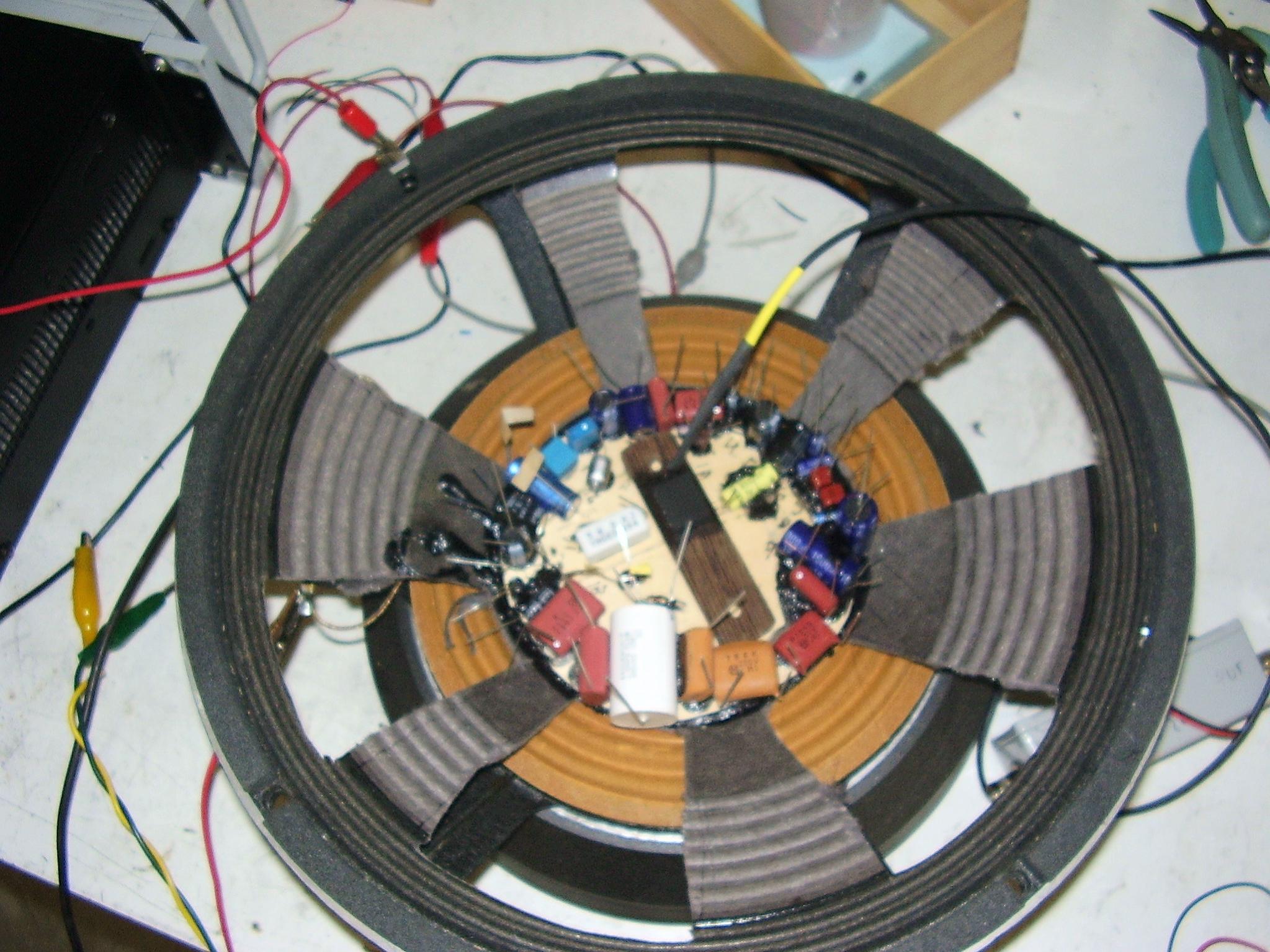

I used my AP and built a shaker table out of a JBL pro woofer. Used an accelerometer to verify shake, rattle and roll.
Stacked plate capacitors could be oriented so the microphonics were minimized. Electrolytics had minimal problems. The physically larger version of many capacitors of the same manufacturer and type also were better.
No real surprises.

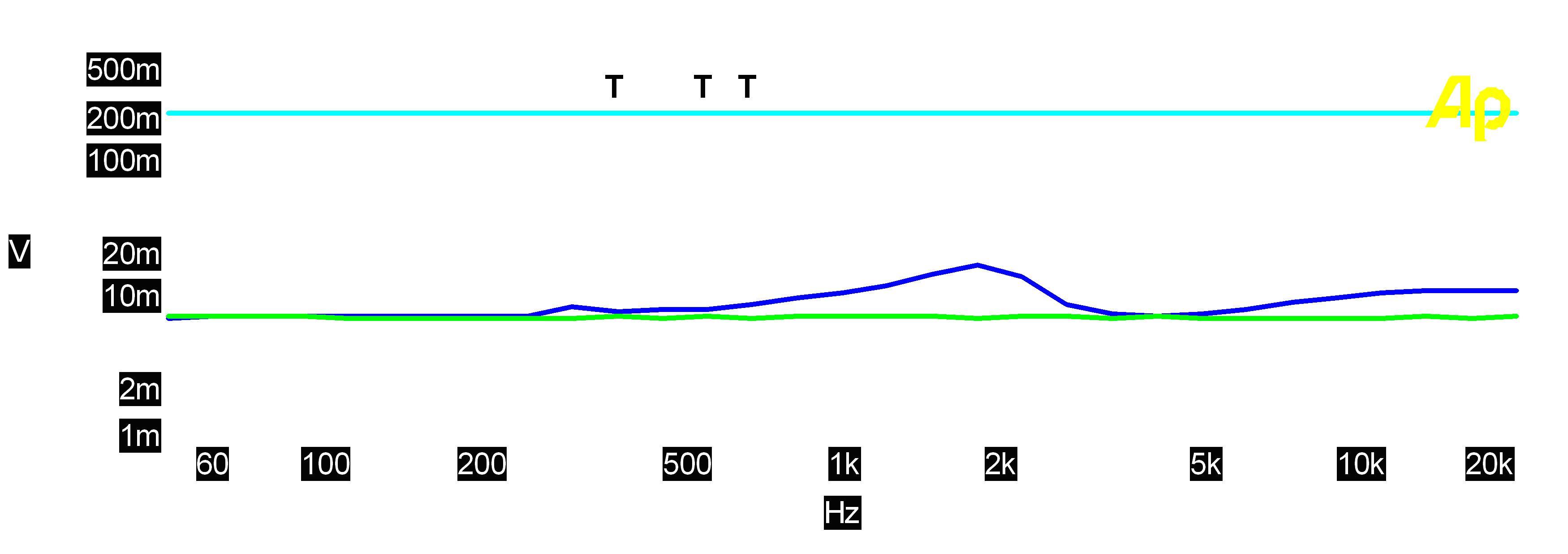

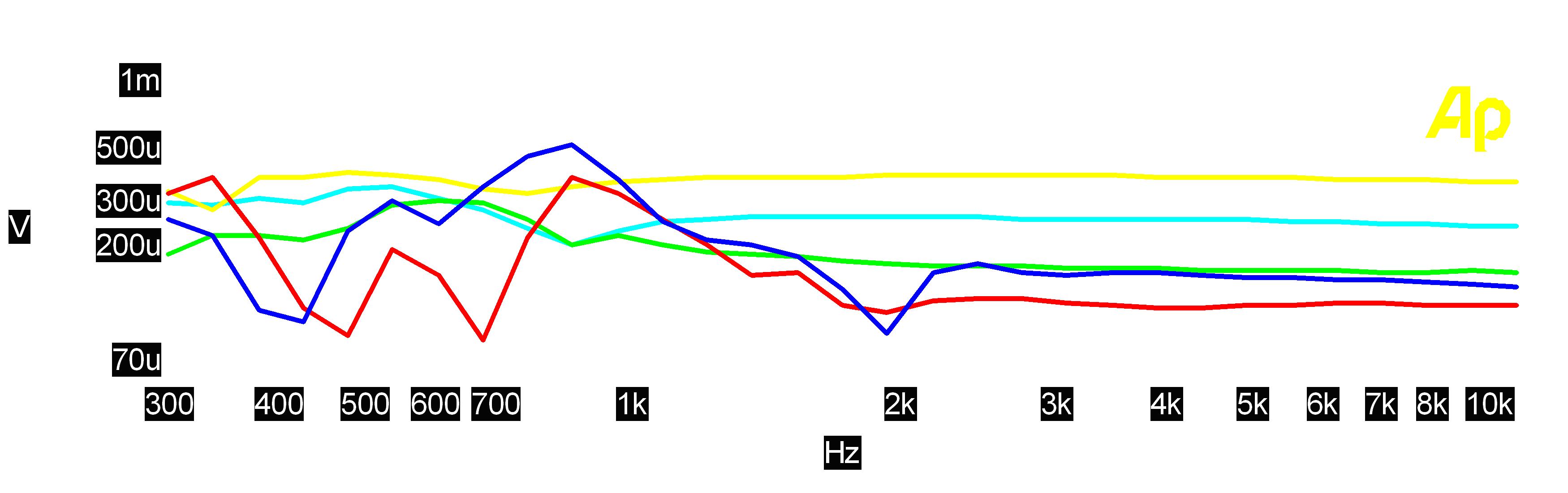

I used a 9V battery with a resistor to bias the capacitors and monitored the shaking with an accelerometer. First graphs are accelerometer, resistor and ceramic capacitor. Second is various capacitors. Somewhere I have the labels. But the final picture pretty much shows all the devices under test.

Nice.
