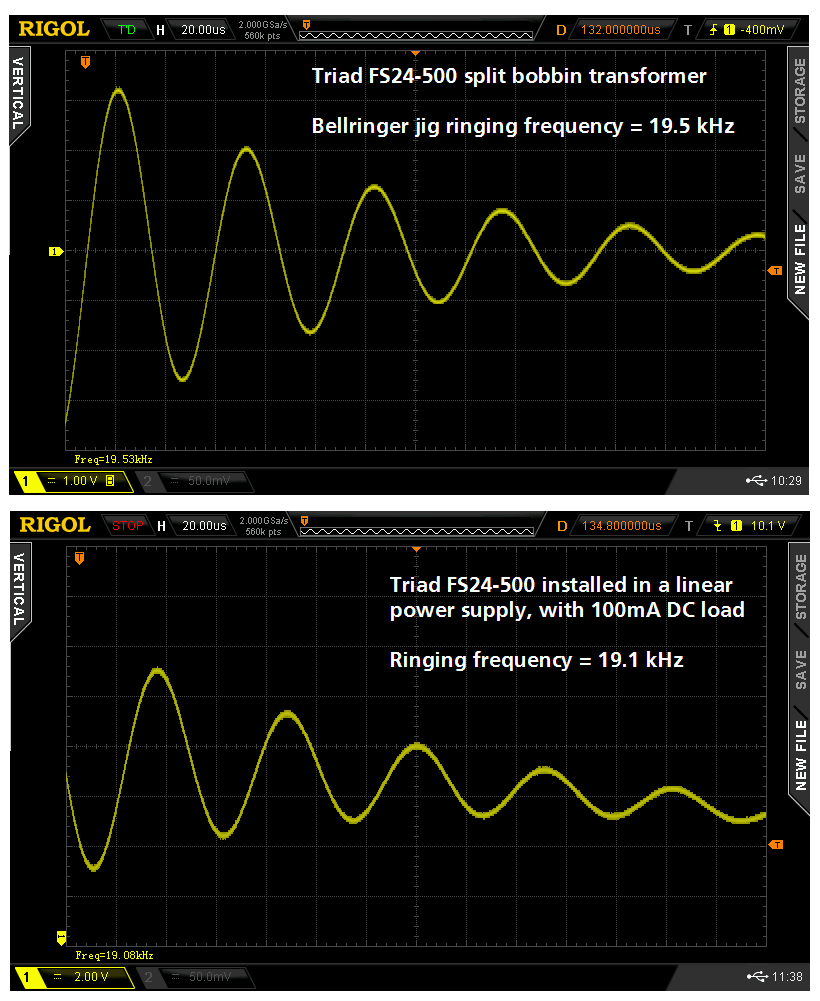

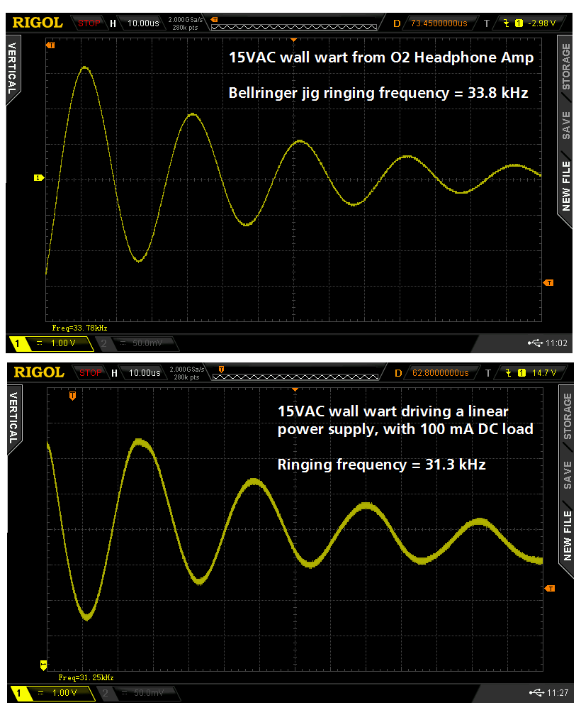

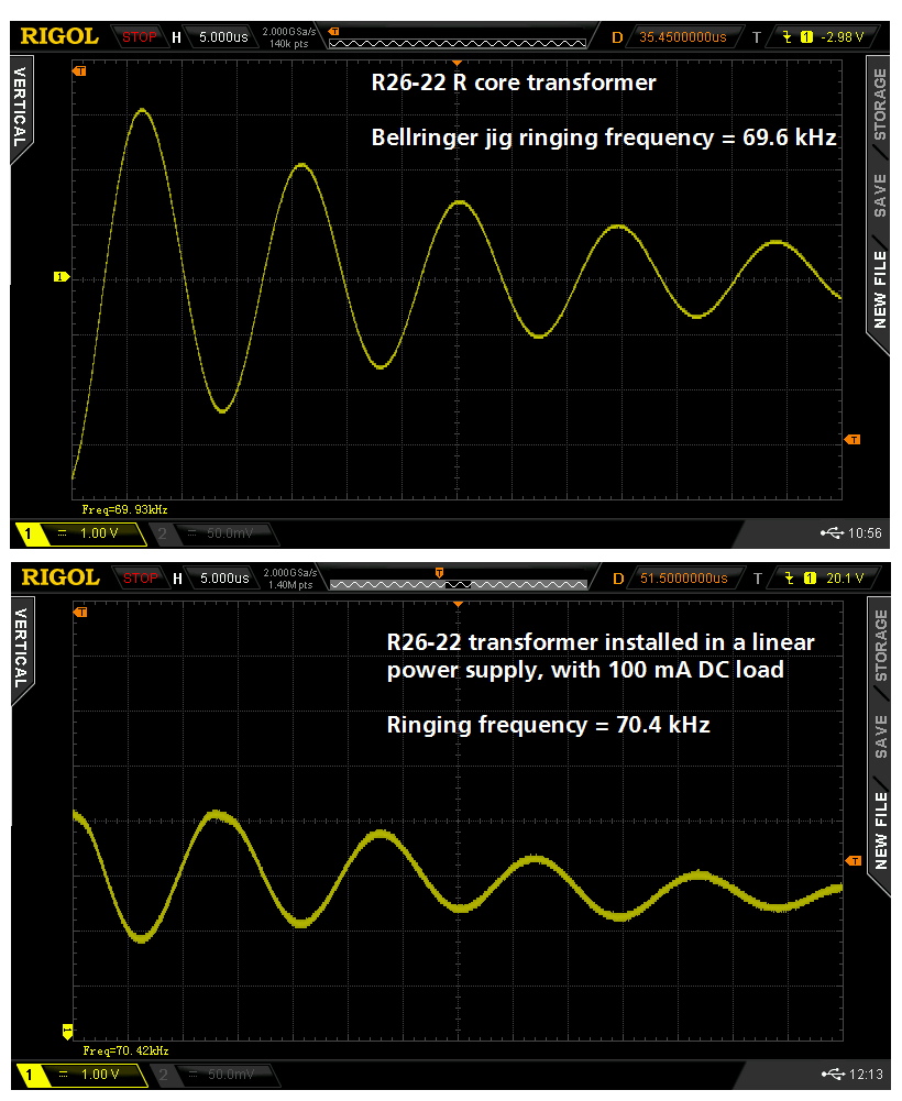

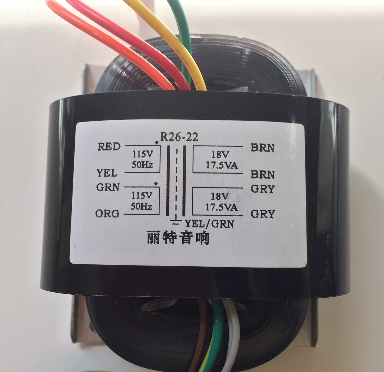

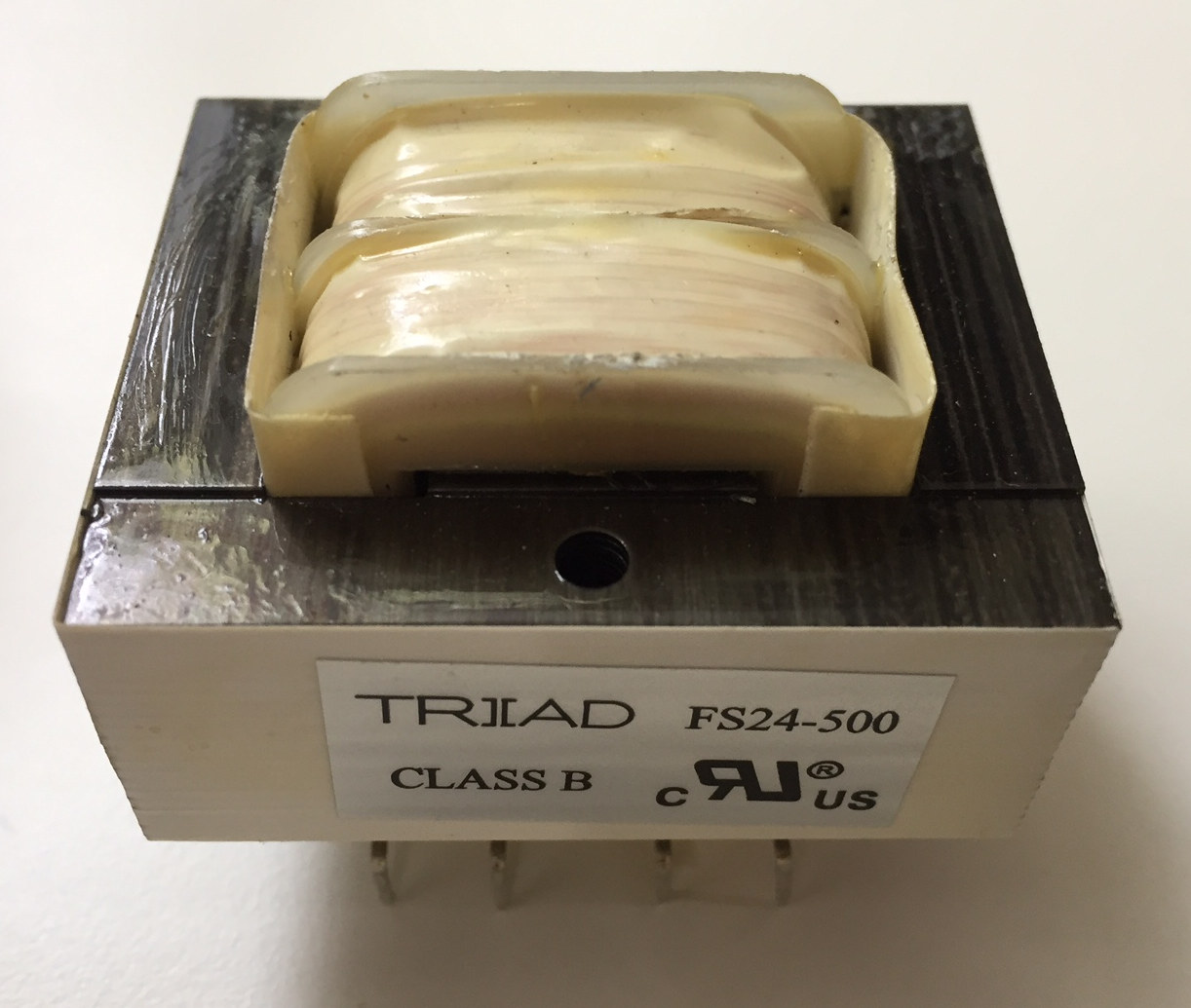

I tried a similar experiment this morning, using three different transformers. #1 was the 15VAC, 500 mA wall wart shown in post #91086. #2 was a Triad FS24-500 split-bobbin transformer, shown in image 1 below. #3 was an Rcore transformer I bought from seller "DIYaudiokit" on eBay, shown in image 2 below.

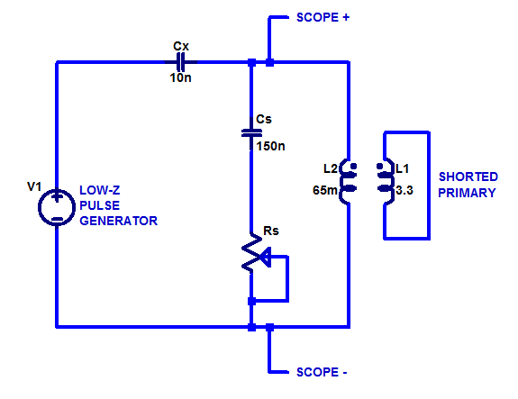

First I tested each of the three transformers on a bellringer test jig, whose simplified schematic is image 3 below. I set the DSO to measure the ringing frequency, it's displayed at bottom left of the scope photos.

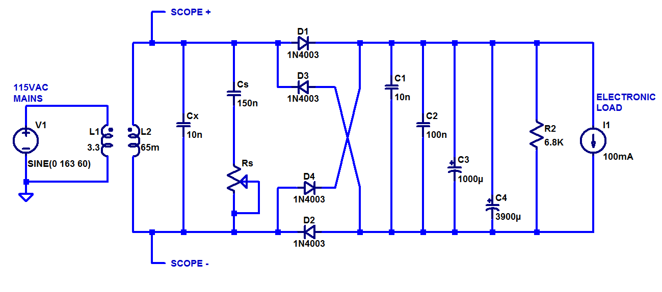

Then I installed each of the transformers into my test board / linear power supply, with 100mA DC load connected. The schematic of this arrangement is image 4 below.
My results are shown in images 5, 6, and 7. To summarize:

15VAC wart 33.8 kHz 31.3 kHz
Triad FS24-500 19.5 kHz 19.1 kHz
R_core R26-22 69.6 kHz 70.4 kHz

Besides avoiding math altogether, the really great thing about tuning a snubber while observing the ringing on an oscilloscope is: you actually see with your own eyes, exactly what you're getting! If an inferior snubbing capacitor is causing misbehavior: you'll see it! Your scope trace is zoomed in upon the exact fine-grained behavior that matters. If you like what you see, yer done. If a capacitor made with lead alloy plates and gutta-percha dielectric gives pleasing waveshapes: be pleased. Yer done.
Me personally, I tend to prefer a certain line of EPCOS film capacitors for snubber use (Quasimodo design note p.7) because their loss angle (tan δ) is small. Some people feel that safety-rated X capacitors are a good idea for across-the-secondary use {Cx in #91143}; these folks think that if the mains voltage spikes from 230VAC to 2300 volts, the secondary will spike 10X as well, and you don't want your across-the-secondary capacitor Cx to pop. On the other hand, if the secondary is connected to a bridge rectifier which drives BIG filter capacitors, half of the bridge will be forward biased and it will simply connect the surge to the filter caps. This will conduct ENORMOUS currents that either blow the fuse, or blow the filter capacitors, or both. But in either case the snubber cap doesn't see 2300 volts so it will survive the carnage just fine.

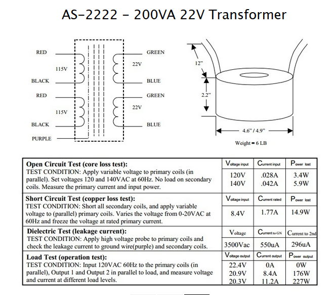

How do you feel about green wires connected to the secondary? PassDIY and diyAudio preferred vendor Antek routinely uses green wires for secondary connections, see image below.I see a serious problem with your R core transformer. It use a green wire for a primary conductor. To me that makes it unacceptable.
