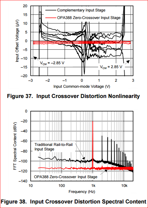

Another sidestep that should generate some interest:
The new OPA388 is touted as having 'no input crossover distortion'. They claim that complementary input stages (you know, the upside-down P- and N-LTPs) have input crossover distortion. This config is found in rail-to-rail input opamps.
The OPA388 circumvents this by having an integrated charge pump so they have additional supply to do R-R input without having to resort to complementary LTPs.
Question: how credible is this? Has anybody ever tried to measure the 'input crossover distortion' of complementary input stages? If this is real it has obvious implications for complementary audio input stages.
TI did, see attached.

When you look at those graphs it happens as the CM input voltage goes through zero, not so much as the input voltage approaches the rail.
If you imagine an audio input stage with the input to one side of the (complementary) LTP, the feedback to the other, the 'input crossover' would then coincide with input signal zero crossing (assuming negligible phase shift).

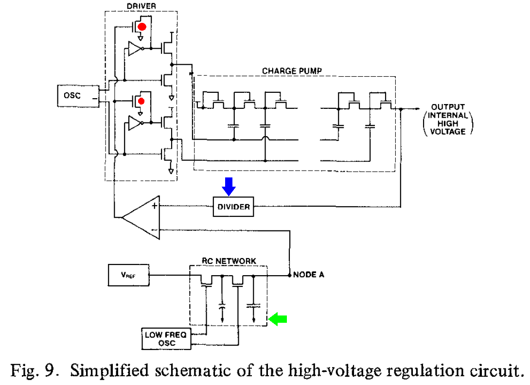

Aaaaaaand, it's unexciting.
The big innovations were
_
- (red): disabling the clock driver when the charge pump output voltage is high enough
- (blue): on an NMOS EPROM process that does not include resistors, building a precise voltage divider using switched capacitors
- (green): implementing a long, long timeconstant lowpass filter using switched capacitors. You can get fast wake-up at power on by turning on both switches, temporarily making an RC lowpass filter with R=zero.

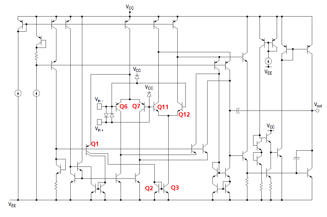

Not really. It's more like "avoidance of gm-doubling". See figure (MC33201 opamp)So these stages in opamps run in class AB, sort of?
Q1 is the evil bastard who causes "input crossover distortion".
If the common-mode input voltage is very low, the PNP input pair Q6-Q7 is active. Their emitter ("tail") node is so low that Q1 is OFF. With no collector current in Q1, transistors Q2-Q3 are also OFF, and so the NPN input pair Q11-Q12 are OFF too.
Now suppose the common-mode input voltage is high, so high that Q6-Q7's "tail" node is high enough to turn on Q1. Q1 steals the tail current from Q6-Q7 and directs it into the Q2-Q3 mirror, where it becomes tail current for the NPN input pair Q11-Q12.
Aha, we have avoided gm-doubling by ensuring that only one of the two long-tail pairs is ON and we have forced the other to be OFF.
BUT!! What happens at the transition? "Input Crossover Distortion" that's what!
Yes, yes, this example is bipolar but Jan's datasheet is about a CMOS opamp. The same thing is happening in both cases but I figured you old, tired, burned-out, dont-make-me-think, bipolar guys would prefer to look at a bipolar schematic. If not, or if you don't trust me, please feel free to pull up a CMOS RRIO opamp schematic your own self. You'll find an evil bastard MP1 that steals tail current from a PMOS long tailed pair and sends it to an NMOS long tailed pair.
