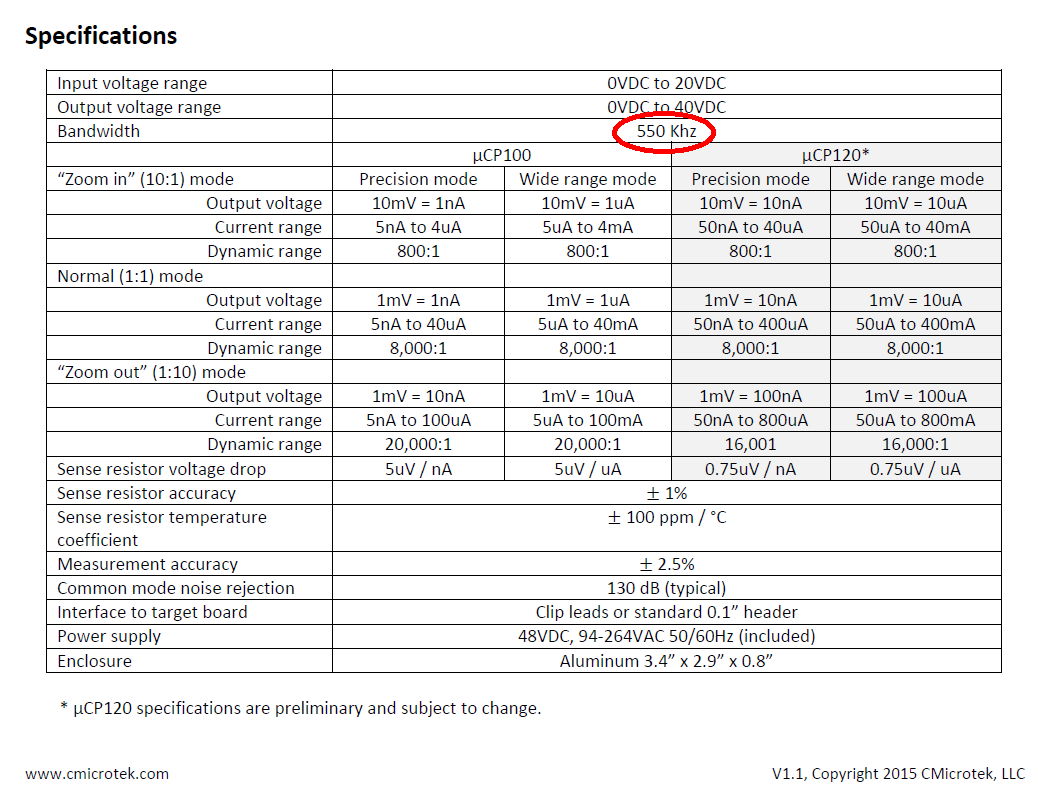

For that money (a trifle more) I'd get this:
CMicrotek - Products
Jan
Thanks Mark and Jan. I'm following with interest as I don't always trust my calculations when it comes to this.
Mark -- How do like the little JinHan scope in general?
Jan the CMicrotek datasheet lists a bandwidth of 550 kHz. Higher than the Pete Millet device but, in my opinion, not high enough to observe transformer ringing. In addition to that, it's far far easier to view the ringing *voltage* since the magnitude of the ringing voltage is 10% to 30% of the peak-to-peak secondary voltage. The magnitude of the ringing part of the *current* waveform, is less than 1% of the peak-to-peak secondary current. You lose about 4 bits of resolution if you decide to measure ringing current instead of ringing voltage.

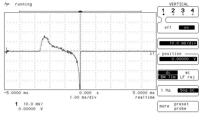

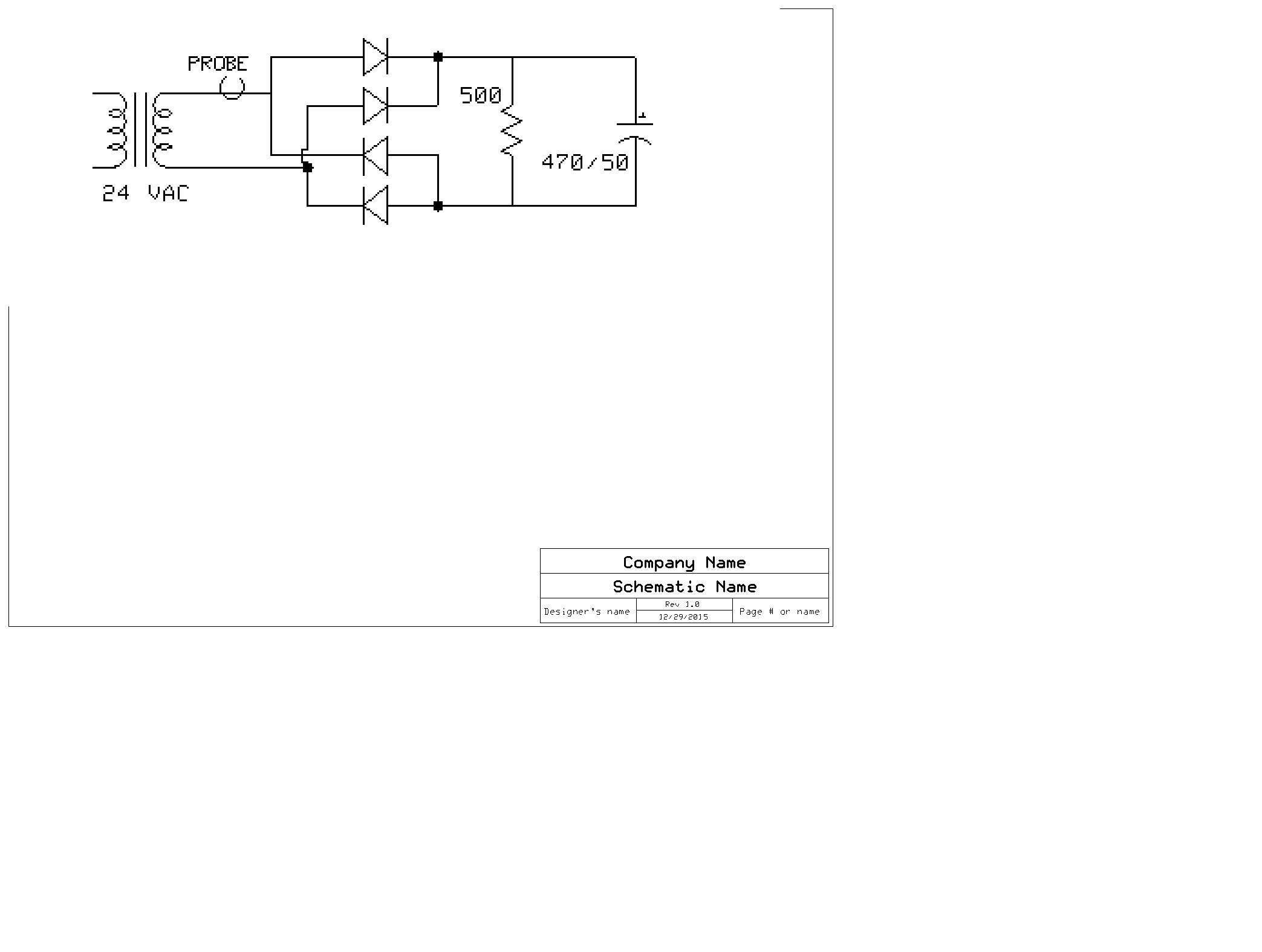

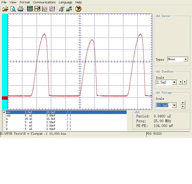

Mark,
In my look at power supplies (still continuing) it seemed that most diodes conduct for about 30% of the available time. This is due to the transformer voltage rising as the current drain drops.
I do like your scope shot that seems to clearly show it is diode turn off that is the issue. Most folks seem to talk about turn on.
Also of note is shown that line noise mostly passes when the diode is conducting, and that the transformer used for the current timing has a center tap that really ain't.
Also note as I think the current probe I made was show here way back. I bought a bunch of ferrite transformer cores and built a bunch of probes and pick the one that best shows the frequency range of interest. For low frequencies I just run a extra lead through an open frame audio transformer.
